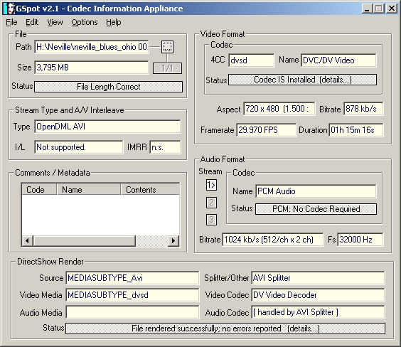

  13. hello. i tried the type 1/type 2 conversion tool and the app said "not a dv type 1 file". surprised me.
    then installed the Pansonic codec (thanks) and that allow me to open it and extract the wav.
    still not sure what codec this file is using. posted a pic of it from gspot. are DV codecs all the same, within types at least? doesn't seem like it.
    if i recorded the video in vegas (from my camcorder/firewire) and that's supposed to be type 1, but the converter says it isn't, but panasonic codec allowed it to be open in vdub which only opens type 2. then what the hell is it?
    thanks.

    Just noticed from your Gspot screenshot, your audio is 32Khz. Dont forget to re-sample to 48Khz for DVD. Goldwave is good for this, or vdub at the same time as you extract it from the avi.
    Mar 2003
    Uranus
    Where did the 878 kb/s video rate come from ?
    DV is around 28 Mb/s

    I think Gspot is not telling the truth about the bitrate or the file is trashed
    or modified. How big is the file ? is it about 3.6 Mb/second ?
    Just grab some of it with DVIO (or whatever) and open it with Vdub and
    see what it looks like
