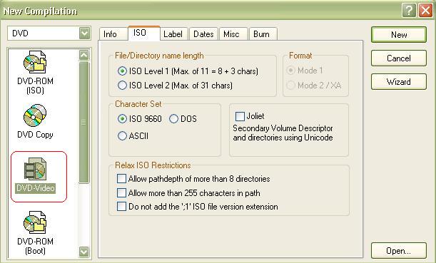

Did you use these settings in Nero?
When burning in nero use the following settings;
1)DVD-ROM(UDF/ISO)
2)No Multisession
3)ISO settings ISO level 1,ISO 9660 (Joliet is disabled)
All ISO restrictions Disabled(Allow path depths etc OFF)
Also, make sure your AUDIO_TS folder is empty, and use the proper DVD template in TMPG for your region. For example if you are in North America use the NTSC template. If you don't change the settings for resolution, audio sampling frequency, and framerate, TMPG will create a DVD compliant file for you. Using the settings I described above and choosing physical partition/1.02 in Nero should give you a proper DVD.
If you used other settings, this may be why your DVD doesn't play in your standalone. I also went to the Pegasys site and your burner is not listed as being supported by TMPG's burning engine. If you authored the discs properly and you use the settings I posted here in Nero, you should have no problem. If you still have problems then you are probably using bum media, or have a bum burner. -

When burning in Nero use the following settings;
1)DVD-ROM(UDF/ISO)
2)No Multisession
Also, make sure your AUDIO_TS folder is empty, and use the proper DVD template in TMPG for your region. For example if you are in North America use the NTSC template. If you don't change the settings for resolution, audio sampling frequency, and framerate, TMPG will create a DVD compliant file for you. Using the settings I described above and choosing physical partition/1.02 in Nero should give you a proper DVD.[quote]
Thank you for that info. I tried the above settings and it worked this time. Hopefully I can find some settings that will make burning with TMPGEnc DVD Author work also to make it a one program operation. Thanks again.

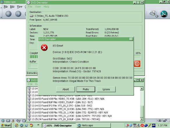

Hey Defense, I just got home from work. Ok, I did what you said to do above. I attemped to make an ISO from the "perfect" +RW copy that I made from the original +RW disc that the movie is on. When I tried to do it, I got the resulting error. Please see the attached screen capture.....Originally Posted by defense
Just a couple of thoughts:
I've never been able to make and ISO image of a DVD+RW!
Is it a bug in DVD Decrypter or is it because of the fact that DVD+RW is not finalized ( since it's not required)?
You are not the only one who can play a wrongly chosen DVD-ROM(ISO) compilation burned on DVD+RW in standalone player
I think this is also because the DVD+RW doesn't require finalization.
Somebody please correct me if I'm wrong.

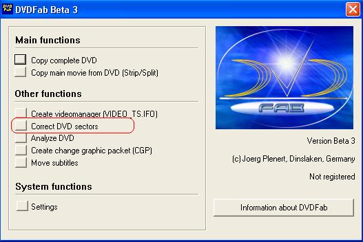

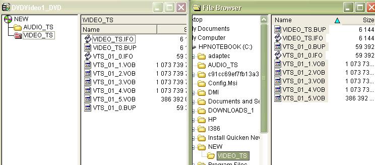

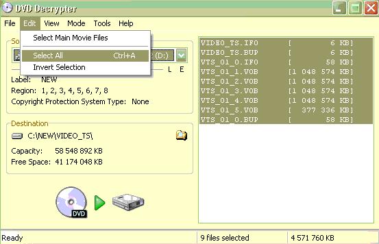

i am x, here's what I would do:
1. Rip your movie in FILE mode (all file)
2. Correct the DVD-sectors with DVD Fab (you have it anyway and it takes a sec)
3. Burn with Nero as DVD-Video ( it does burn UDF 1.02 and you don't have to take care of ISO-UDF setting and it creates the VIDEO_TS, AUDIO_TS files automatically) -
How do I go about ripping the movie in all file mode? Tell me how to do that, and I'll give your idea a shot. Also, how do I correct the DVD sectors, and which DVD do I correct the sectors on, the +RW that the movie is burned on, or the copy of the +RW that I make?Originally Posted by tompika
Ok! THANKS! I'm going to give it a shot right noe and see if I can get this darn burner to burn me a DVD-R that will play in my standalone! I'll report the results as soon as I'm done.....Originally Posted by tompika
Tompika.....problem. I just opened Decryptor, and guess what? My version has no "edit" option that you depict in your first screen capture. The version I have is 3.1.6.0. Where do I go from here?Originally Posted by tompika
At the same time you sent this message, I figured out how to do it! In the menu, you click on "mode", then it gives you the option to decrypt as files, or in iso, or ifo. Of course I chose the "files" option, then all the files magically appeared on the right side of the screen, just like in your screen capture. Ok, NOW I'm doing it! I'll post as soon as I'm done to let you know what happened.Originally Posted by tompika
It didn't work. I followed every command you gave me EXACTLY. I ripped the +RW disc that the movie is on in "file" mode with DVD Decryptor. It created a directory on my C: drive called c:\Video_Ts. Then I used DVD Fab to "correct" the files in that directory, and that only took a second to do. It even said that the files were corrected. Then I opened Nero and chose the DVD-Video option to burn the files in the c:\video_ts directory onto a blank DVD-R. All the settings in Nero 6 were identical to the ones you had on the screen capture. When the disc was done burning, I popped it in my standalone, and NOTHING. Not a damn thing happened. The disc never loaded. -
