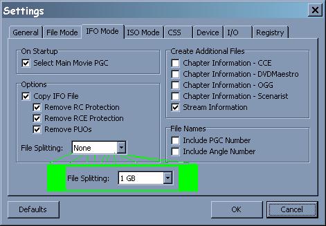

    Open DECRYTOR AGAIN, chose your movie files again..now go to settings>IFO MODE>and you will see a screen like picture below
    pull down and select NO FILE LIMIT and you will have one giant VOB
