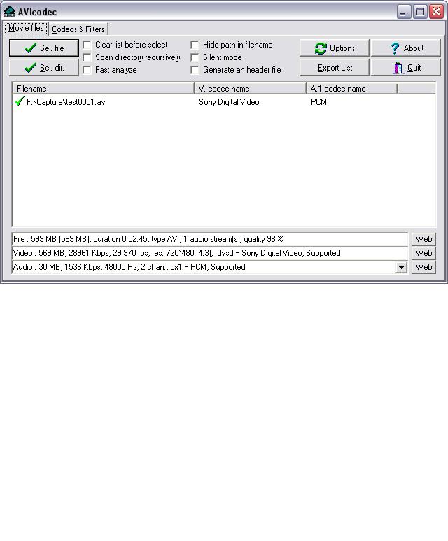

  12. When I look at the AVI files with AVIcodec, I get this:
    File : 536 MB (536 MB), duration 0:02:45, type AVI, 0 audio stream(s), quality 58 %
    Video : 536 MB, 27291 Kbps, 29.970 fps, res. 0*0 (), dvsd = Sony Digital Video, Supported
    Codec: Sony Digital Video
    I don't know why it doesn't report a resolution, but the quality 58 % is disturbing. If I knew how to turn that up to 100% or replace the codec, I'd do it.

  18. Just tried ScenAlyzer. Same results.
    Run that thru AVIcodec.....what's it say now?
  19. As a test, I just captured 2:45 seconds with ScenalizerLive, thru my Canopus ADVC-1394 using the Type2 DV-avi file (Premiere, Vegas, Etc) which on my machine is the Panasonic codec, although it shows up in AVIcodec as Sony.
    This is the result...............
    I normally use the Canopus codec, but the results are similar.

  22. Boy! Many good posts to reply to. I'll try to keep things straight.
    vhelp: I've been encoding to DVD spec, 720x480 @6000bps using Arcsoft Showbiz. Then I either dump the MPEG onto a non-standard SVCD (retaining the DVD-specs... my DVD player plays anything!) or author a DVD-RW. Both methods produce the same poor results. I'll try encoding with TMPGEnc to test that idea. However, the resulting MPEG files (Arcsoft Showbiz encoding) look identical to the AVI files when viewed on the computer.
    The source video I've been testing with is outside daylight and digital image stabilization was used when originally videotaped. So... I'd almost rule out your ideas on that topic as a cause of my problem.
    Kool_Aid: I get the same results as the picture posted right after you're post. AVICodec still reports Sony DV Codec.

  23. The first time you posted a quality of 58%
    Have you got that closer to 100% now?

  25. Kool_Aid: I believe it stated 98%, but the AVI looked the same during playback. How bad should interlaced high quality video look on a PC monitor?
    Foo: If you could direct me to information as to how to control/install/remove/specify video codecs, I'd greatly appreciate it. This is likely my next avenue to try after I encode a ScenAlyzer capture with TMPG to rule out the encoding step as the problem. I know where to find the installed codecs in the device manager, but that's about all I know.
