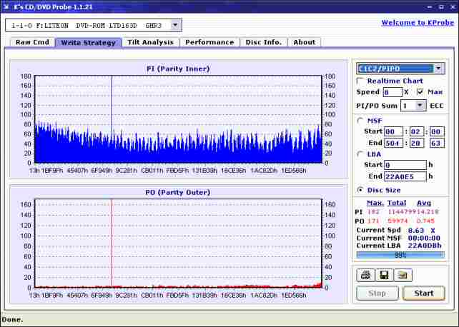

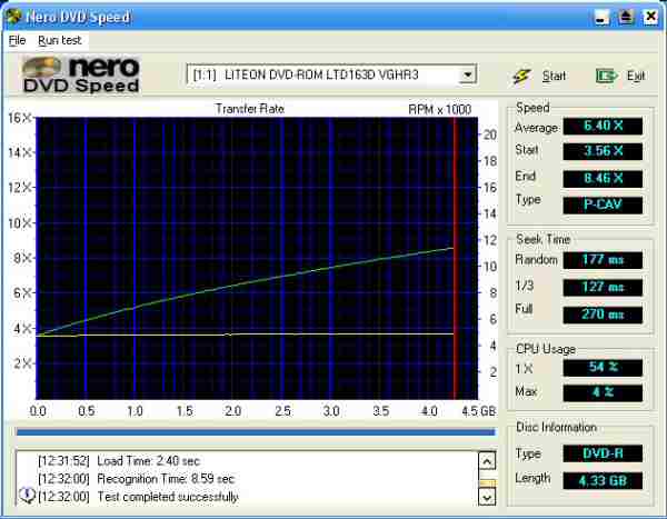

    This media has a long and dubious history, before you even think of buying or trying them, I highly suggest you read through this thread. I stand by the finding with the 3 that were tried of this new batch of disc, BUT I cannot say anything of the quality control, and I cannot swear that they didn't dig through an entire stack of disc trying to find the good ones I was sent. Of course I cannot say that they did either, but please be aware of the chance if you do decide to order them.
    So a good friend of mine hooks up with some of the samples of the Matrix 4x disc that shop4tech.com seems to be pushing so very hard, after about a week he gets a couple of them to me for testing.
    The media itself looked ok, viewing the top "shiny side" I did notice the internal part seem to be slightly darker then the outside which I found odd. Upon insertion my DVR-105 it took a strangely long time to be ready to burn, it seems to not like to ID as a burnable media very quickly. After the burn it would not read back in my Apex DVD player, personally this is the kiss of death, I will test no further, and I did not.
    Today I get awakened by a phone call, without request my friend has gotten another small batch in, they claim they are more compatible with the Pioneer drives now, "Ok here we go again" I think. The results were quite acceptable so far. What follows is the Nero dvd speed, and kprobe results from the media.
    Its ID time seems to be alot closer to most other medias, it sees its a burnable disc at a decent speed. It burned fine at 4x all the way through in my testing. Also the media seems to play fine all the way through on my Apex AD1500, but I have not tested it on any other players at this time.
    Please note that I'm not sure if these new samples that we have are what is currently shipping, if I was going to order and try them I'd call and ask first cause if instead of the new ones they sent the old ones I think you would be quite disapointed. Also these are not Certified 4x disc from the DVD Forum, like most the cheaper 4x disc.
    Just an FYI.

  20. @ flaystus: use the PNG image format next time for screen shots. It generally can work much better than JPEG.

    Yeah those are a little over compressed compaired to the originals, but I figure the board will not accept the jpeg files using the same settings I use for DVD covers, so I turned up the compression. Should still get the point across though.

    That KProbe report looks real bad! There is an abundance of errors, completely unsuable.
    Your KProbe result looks worse than the result I posted a while back. ( https://www.videohelp.com/forum/viewtopic.php?t=167355&highlight= )
    Shop4tech sent me some media 3 or so weeks ago. The dye layer has already separated on all 5 samples. I litteraly pulled the film out between the two plastic layers on one disc.
    I thought this media looked very similar to the "OEM" Maxells. They both have IFP on the center hub.
    If your searching for cheap 4x media, Princo and Lead Data (DupEz, Accu) are a far better deal.

    I've used media with FAR worse Kprobe results then that well in the past. Take a look at some of these, and note that not one of them failed to play.

    I'm sure some players can play media with far more errors. My Apex 5131 can play 1x princo past the 4gig mark, where as my other 4 players hard lock at that point, and read errors happen with my PC drives at that point. Doesn't mean it's quality media just because a hand full of players can read it.
    I know you still have some of those OEM Maxells. Take a look at those, and compare them to the Longten. The hub codes have the same ID, IFP. If I was a gambler, I'd bet all my money these two discs are made by the same people.
    Making a test report after burning only 1 or 2 is hardly inclusive. You made the same discovery with the OEM Maxells. After testing one or two pieces, you concluded that the media was great. After the 5th one or so, you sent them back to meritline
    The "new" media you just got is the same media defense and I tested a month ago. The OPC and write stradegy is the same.
    (Your link goes nowhere)

    Sorry about the link, I'm half asleep at this point. The correct one is: http://www.crystalmidnight.com/dvdtest
    As far as players we've now tested these few samples on 3 different DVD players, all 3 played them, but like was noted the Oritron had a strange whine when doing so.
    As far as the fake Maxells go, I had bad luck, but I never burned a test disc until the media came in, it was a gamble I knowingly took based on the fact that meritline promised to replace them if they were awful, which they did gladly. Of the ones I tested all but one or two were really crummy. On the same note my friend also ordered 100 of them just days after I did and he is currently on his last 10 or 15 of them with not a single problem at all.
    I think that perhaps these disc are better then the previous ones, the only reason I'm not considering NOT ordering the disc is the fact that shop4tech was so quick to show back up with their same old useless tricks again. Just as perhaps they are onto something good, just as someone is willing to say that the disc work they come in and make themselves look silly trying to create a hype that isn't needed if the disc really are better now. Sad really. I'm gonna decide later when I have some sleep rather I'm getting these, or just ordering some 1x optodisc instead.
