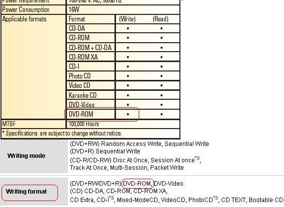

Your Aopen writer is an OEM Ricoh 5125a.Originally Posted by John Cleese
That means it supports bitsetting.
You should be able to set the booktype in Nero both for +R and +RW medias!
Due to my little experience the Pana RV32 likes the DVD-ROM booktype,
but with NicW's DVDInfo PRO can set any Booktype for DVD+R/W.
I suggest you change the drive's default settings to DVD-ROM it works for me every time.
But don't forget NeroBurningRom is the only one that overwrites the default drive settings! Bug! -

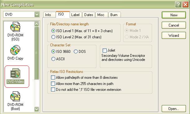

Just got Nero 6 and saw that setting book type is still available, i tried burning an +R, with settings DVD-ROM, ISO and then marked the book type dvd rom stting, Panasonic RV32 said again No Disc. -
If you're saying you chose DVD-ROM (ISO) compilation instead of DVD-Video you did wrong.Originally Posted by John Cleese
Supposed to look like this.
BTW, last time I had burning error I was using 1.27 or 1.38 firmware.Originally Posted by John Cleese
What's yours? -
Very happy now, I burned a few DVD+R's now with selecting DVD-VIDEO instead of Iso and marking Book Type and they all succeeded, so finally after months of trying and wasting money on +RW's it worked, Thanks a lot.
Strangly i did burn in the past all my +RW's on selecting DVD-Rom, Iso and they all play perfectly, so ?

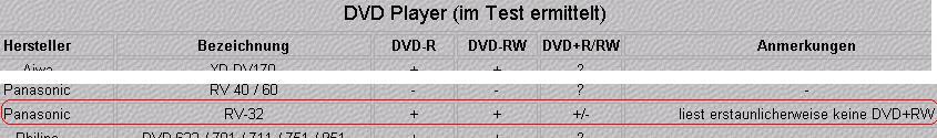

https://www.videohelp.com/dvdplayers.php?DVDnameid=1069&Search=Search&#comments
It says it plays DVD+R but it doesn'play DVD+RW when it's supposed to

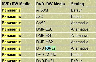

http://www.dv-rec.de/technik/dvdrw/index.shtml
This is from HP site, says DVD+RW only with compatibility bitsetting
http://www.hp.com/cposupport/information_storage/support_doc/lpg41401.html#N12515
I also found that there could be firmware differences between European and American versions -
