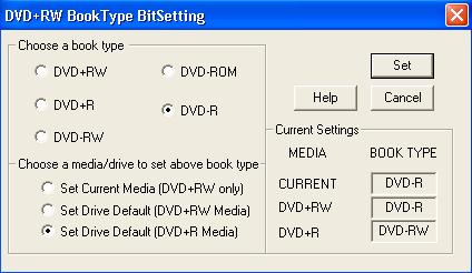

  2. And here is a pic.
    You must know lot about dvd writers.
    This is probably the only utility that writes minus booktype.
    But what is the point of setting the booktype to other than DVD-ROM when it always delivers?

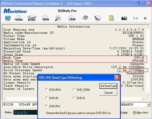

    Well here we go:
    Media Information
    Disc Regions are 1,2,3,4,5,6,7,8
    Media code/Manufacturer ID RICOHJPNR00
    Format Type UDF 1.02
    Volume Name 030804_1224
    Application id
    Implementation id Prassi
    Recording Date/Time (mm/dd/yyyy) 8/ 4/2003 12:26:52
    Formatted Size 4.14GB(4.45GB)
    Total Size 4.14GB(4.45GB)
    Book Type DVD-R
    Media Type DVD+R
    Default DVD+RW book type DVD-ROM
    Default DVD+R book type DVD-ROM
    Media Id Code Speed 2.4x 3324KBps
    Available Write Descriptor CLV 2.4x 3380KBps
    Available Write Descriptor CLV 0.0x 2KBps
    Data area starting sector 30000h
    Data area end sector 2123DFh
    Linear Density 0.267um/bit
    Track Density 0.74um/track
    Number of Layers 1
    Glance a look at book type...oooops DVD-R...he he he
    Plays flawlessly too....hmmm

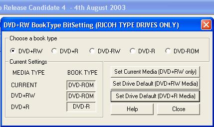

  9. And here's the pic:
    It took them a couple of hours to make it.
    Bitsetting has been put on a new level.
    It's revolutionary.
    I guess you're gonna have a dual firmware patched by the weekend.
