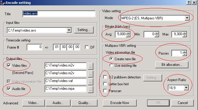

    i dont see anywhere i can set the fps on my CCE. i have the SP version. by looking at the picture from your guide, looks like you had the same version as i do.
    i see "Timecode Setting" there, next to the "Frame #" field, do i just replace the 0 with 23.976?

    The framerate setting is in CCE. Just click on the "Video" button at the bottom left of the CCE Main settings screen to see the CCE framerate. Yours should be set to 23.976.
    The other options I'm describing are set when you run Pulldown on your M2V file to make it appear to be 29.97 fps. They are in the PullDownBatchFE GUI, not CCE. Be aware that PullDownBatchFE. It should NOT be checked. PullDownBatchFE is the program that I'm referring to when I say that the only option that should be checked is the "set drop_frame_flag for NTSC streams" option.
