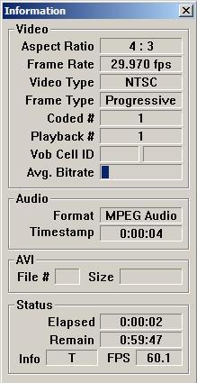

Sorry, I forget to mention, DVD2AVI reported a Frame Rate of 29.970, Video Type NTSC and the Frame Type is Progressive. The video is not telecined, I checked that by stepping through a few frames with VirtualDub.
I think I have to do a full Framerate conversion, but I didn’t figure out how to do that. -

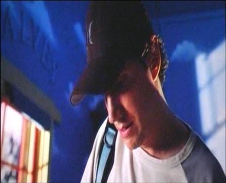

One problem I've had from the start with this process is that the output of my video looks very washed out, even though the color from the orginal SVCD looks very vivid. This has been very frustrating and I've been trying to figure out how to fix this for the longest time. At first I thought it was because I was converting it from PAL to NTSC, but when I took those tags out of the script, it still looked this way, so now I'm thinking it's DVD2AVI. I've tried using a couple of other frameservering programs, but I can't get them to work. Hell, I've even tried converting it first to Xvid and then to DVD (since I know I can do a Xvic/DVD conversion flawlessly thanks to Rumpy's excellenct guide
) but can't seem to get that to work either. Has anyone else had this problem with their video? Any suggestions?
Your probably compressing or expanding the color range. Make sure in DVD2AVI that you select TV Scale, and that in CCE, you select 0-255. Try encoding a small sample. Failing that, if you don't like the same, try setting the color range from 16-235 (you'll find those options under the VIDEO button in CCE). All of this assumes of course that you are using CCE, and DVD2AVI. If not, let me know what methods/tools your using.
One other suggestion. View your video on some other display, be it your PC, or another TV to make sure it's not your display itself.

I've always used the settings you've said, and I just tried changing the range to 16-235, but it still looks really washed out. If it helps any, this problem happens before I ever encode it. I see it when I create the AVS file and view it through my media player, which is why it makes me think it's DVD2AVI or possibly avisynth. Although I've used avisynth to convert Xvid to DVD, and it's always looked just fine, which is why I'm leaning towards DVD2AVI. And yes, I've viewed this on other TV sets and its looked the same. I've been trying to do a screen capture of both versions of the video, but I just get a blank screen when I try to make a jpg, if you can tell me how to do a capture through PowerDVD, I'll post the pics to give you an idea of how it looks.
Please do. If your seeing it with AVISynth, then the problem would definately have to be with either your source, DVD2AVI, or some AVISynth setting. There aren't that many factors that would affect saturation so early in a project. Post em' up here so I can take a look at them.
By the way, what version of dvd2avi are you using? Also, does it look washed out when you preview it in DVD2AVI?Impossible to see the future is. The Dark Side clouds everything... -
I'm using Version 1.77.3 of DVD2AVI. When previewing it in DVD2AVI, it looks perfect (actually looks better than it does in my media player).
And here is the AVISynth script I am using (this is before the cropping and resizing, but color is off before I even put these tags in):

But could you till me how to do a vid cap? Whenever I hit Prt Scr while the movie is playing, all I get is a blank screen in the clipboard. -
What are you using to preview the clip with? The only change your making to the color at all is the conversion to YUY2, which should not affect it visibly, although you could try removing that line to preview it.

Now here's how it looks after I've run it through DVD2AVI and tagged it with the script I listed above:
As you can see, there's a big difference. I captured these two pics from VirtualDub, but I've also used Windows Media Player it still looks the same. -
It hasn't washed out your color, it's just the brightness and contrast that's changed. I can just darken up your existing clip and tweak the contracts to make it look just like the original.
I would suspect that your using some sort of direct show software to decode the source file, like ffdshow, rather than the proper codec, or you've changed your codec settings to change the brightness and contrast levels. Open the avisynth script with zoom player. Then righ click the video, and from the FILTERS menu, it should show you which codec is actually being used to decode the video. Once you know that, you can see about either tweaking your decoder codec settings, or disabling the problem codec if necessary.Impossible to see the future is. The Dark Side clouds everything... -
Hmm, ok I did what you said, but not quite sure if I found the codec. Is it quartz.dll? If that's it, how do I get rid of it and use a different codec?
No, sounds like you went astray
Just open the AVISynth with Zoom Player, and then right click the video while it's playing. Select FILTER PROPERTIES from the popup menu, and you'll see the Video Decoder being used.
