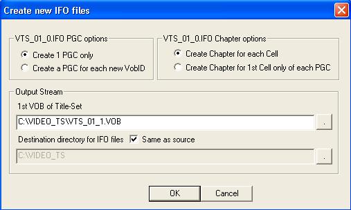

    IIFOEdit----Create IFOs----Open the first VOB (IFO destination same as source).
    What am I opening the first VOB with? Thanks in advance.

    Anyway open the first VOB so IFOEdit knows where to start
  9. I got you tompika. I never used that option in IFOEdit before. Do I need DVDFab to correct the sectors? I thought I could do that using IFOEdit with the "Get VTS Sectors" option. The reason I ask is I am trying to do this process with as little software as possible. Thanks again.

    2) Use IFOEdit to "Create IFO Files" after selecting 1st VOB file.
