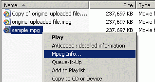

    Ok can you cut & paste the results of a "mpeg info" on one of the mpegs?:

    Hi there,
    Thanks for the quick reply, sorry in the delay in getting back to you i have just been trying a few things. The reason for it jumping through the process so quickly with star trek nemesis was negligence on my part sorry, as i usually always do check mpg info on the mpgs i have just ripped you reminded me to do that. Anyway the 2 mpg files were coming up as invalid mpgs so i didnt bother wasting my time ripping them again, i done another vcd 2 dvd without any problems. The second one i went to do which is the exact same process as described in earlier notes, the 2 ripped vcds mpgs in one video ts folder but this time it is only running through part of the process and only seeing the first mpg, i have named the video mpg 1 and 2 it does number one, goes straight to mptx.exe, then besweet.exe, then it only transcodes mpg file 1 and in svcd2dvdmpg log it says multiplexing elementry streams and goes no further i have done as you asked and copied and pasted the information on both mpgs files which are attached at the bottom i am so sorry about the hassle but can you tell me why it will do 1 conversion and half of another
    Anyway thanks for your time and i eagerly wait your reply
    H:\SHALLO~1\VIDEO_TS\video1.mpg
    Mpeg 1 System File [Video/Audio]
    Muxrate : 1.41 Mbps
    Estimated Duration: 51:22.23s
    Size [352 x 288] 25.00 fps 1.12 Mbps
    Audio : Mpeg 1 layer 2
    224 kbps 44100 Hz
    Stereo, No emphasis
    Press any key to continue . . .
    And file 2:
    H:\SHALLO~1\VIDEO_TS\video2.mpg
    Muxrate : 1.41 Mbps
    Estimated Duration: 57:41.11s
    224 kbps 44100 Hz
    Stereo, No emphasis
    I cant see any difference in them apart from the running time but yet it misses out a good part of the process anyway once again thanks for your time
