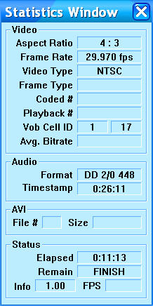

  5. Here is a screenshot of what shows up on the right side of the screen and i watched it through and it stayed the same
    so what should i do now?
    Thanx for everything

  7. VIDEO type is NTSC...
    so in dvd2avi, you need to turn forced film OFF.
    in tmpgenc, the OUTPUT VIDEO needs to be 29.97 fps + interlaced (NO 3:2 PULLDOWN)
    in advanced, source video type needs to be interlaced
