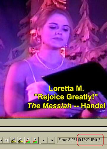

    1. Grab a pad of lined paper and pencil. Divide the page into two small columns on the left and a large column on the right.

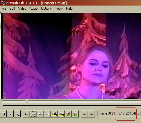

    2. Start watching your home movie. When you spot the place
    for the first subtitle,
    write down the time in the first column, and how long it should last in the
    second column. In the last column, write the subtitle itself, or a short
    phrase that will instantly remind you what the subtitle is.
    Example:
    Start Time:................Duration:..................Te xt:
    0:17:22.154...............:06.00.................. ....Loretta M.
    .................................................. .............."Rejoice Greatly!"
    .................................................. ..............The Messiah
    .................................................. ..............Handel
    0:55:37.27 ................:07.00......................Letizi a I.
    .................................................. ..............Concerto for Violin
    .................................................. ..............First Movement
    .................................................. ..............Mozart
    Repeat this procedure until you have gone through your movie.

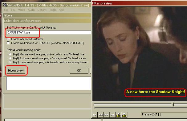

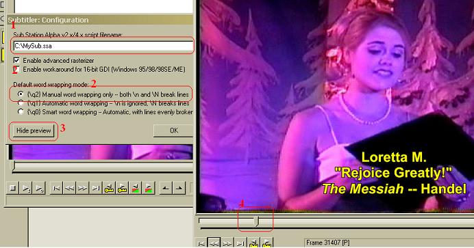

    5. Now open Virtual Dub and load your video. Select Video-->Filters. Select Add, and when the filters menu opens, select Subtitler. Load the .ssa file (1), select option "\q2" (2)and select Show Preview(3). Use the slider (4) to find your first subtitle.

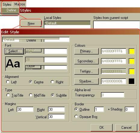

    6. If the font is too small, too large, wrong color, etc. return to Sub Station Alpha. Open Style-->Define....Select Default or open a New style and change the font attributes. If you have to change the text or add/delete a line break, remember to hit Return before saving, or the chanfge will not take place.
    Save again and repeat 5tep 5. If the video is correct, close Sub Station Alpha and save the file or frameserve to
