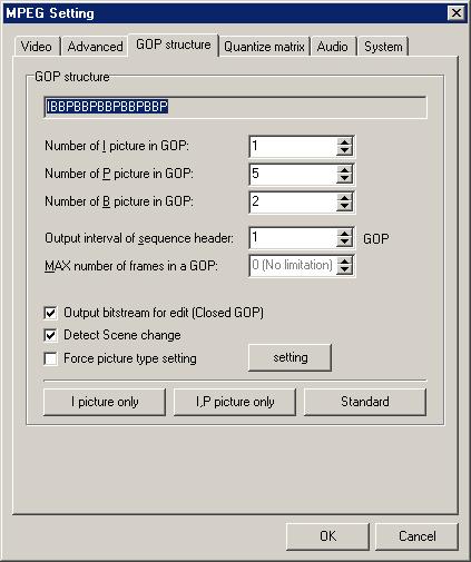

  2. for the chapter issue, when incodeing the file go to
    settings > (or advanced if your using the wisard)> GOP stucture and check > output stream for edit ,close gop > and sequence header every gop, not sure if this has to be any # exactly but i use 1 for i pictures, 5 for p and 2 for p

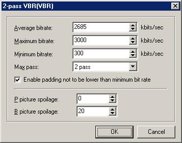

    the autopadding, can be a pain, as it will take your 800mb file to a 900 mb file,
    i have simply checked the box under tab mpeg settings > video >Video rate control > settings and checked enable padding not to be lower that min, and put usally 300min
    the min on some players has to be low and not on others > as i have read around.
    so you will have to find what works for you.
