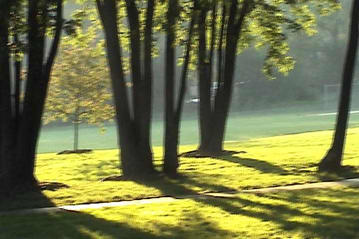

I filmed video in 16:9, and used Vegas 4 to edit. When I capture video filmed in 16:9 from my camcorder, I have a 740x480 frame that looks like this:
Its not very apparent here, but the image is stretched vertically. My video camera uses the full 480 lines even though its widescreen. So when you shrink the picture vertically until the aspect ratio is correct, it will be the letterboxed size you assosciate with 16:9. Vegas does this, so it looks like this:
Notice the image was only shrunk vertically, the width remains the same. Now since I'm shrinking an interlaced image vertically, and not by 2x, the interlacing is going to cause a problem, right? It does, as in shots like this where I'm panning, you can clearly see the interlace lines, even on a TV.
I guess a solution would be to deinterlace the captured video, size it, then re-interlace once I finish editing, but in that case aren't I loosing alot of quality?
Whats the real solution here, Im sure they had something in mind when they build my camera? Anyone..?
