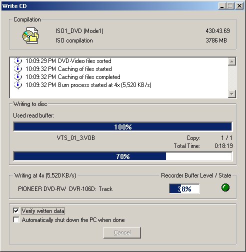

    I disable the buffer underrun of the dvd-writer and choose "simulate" on nero.
    4x: it hangs randomly. by hangs, it likes it doesnt progress anymore(progress bar doesnt move, buffer bar doesnt move), but I can abort, wich mean Nero is still responding.

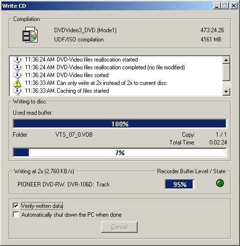

    2x:
    Look, there's a warning in the nero log.
    Am I forced to burn 2x on my A06u??
    Because the burn with 2x seem working
    (not concluded yet)

    Ok guys and girls
    burn @ 2x is working fine...
    I installed PowerDVD, and it says DMA is enable.
    Is it "normal" that I cant burn on 4x? My PC is not fast enough?
