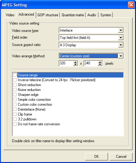

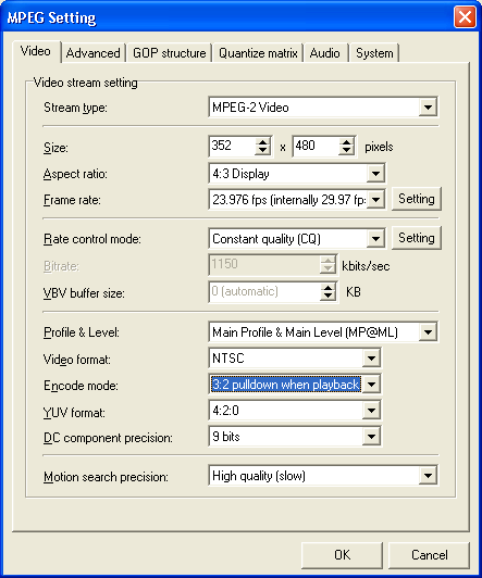

look if you want to put your divx on only one cd, i know just the way to do it, and it will be very compliant, cause it will be cvd, but only i will do center(custom size) and i will put 320*240 or wait first tell me is your movie widescreen, or full screen, and tell me the lenght of the movie.
An all in one guide for DVD to CVD/SVCD/DVD by cecilio click here--> https://www.videohelp.com/forum/userguides/167502.php -
Originally Posted by faithfoo
VCD's are burned in mode 2 and allow 800 MB on a typical 80 min/700 MB CD-R.Originally Posted by ZippyP.
The only way I know to gauge filesize when cutting is to calculate MB/min. Use the size of the file and divide by the total length of the video in minutes. Use that figure to roughly guess the size of your clip."Art is making something out of nothing and selling it." - Frank Zappa -

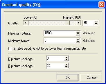

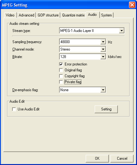

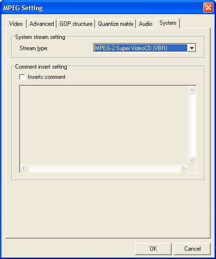

look lets say your movie lenght is 90 minutes than do this if its different tell me and ill change some settings.
Then if the movie is full screen do this

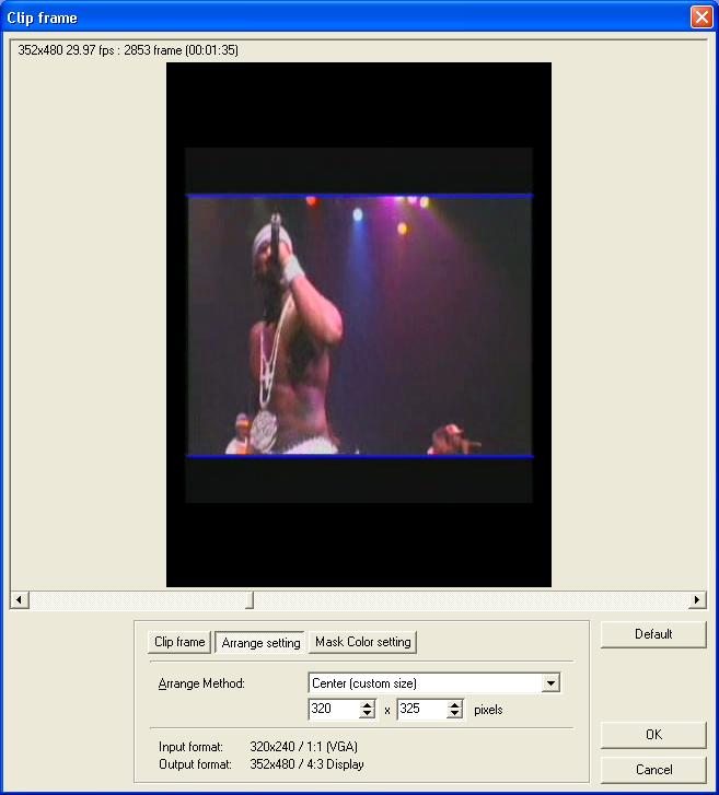

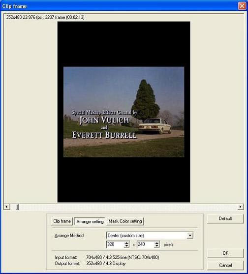

then this is how your full screen movie will look like first go to clip frame and double click there and then go to Arrange Settings and it should look like this
yea it looks a little weird, but once you encode it it will look like a normal widescreen movie and it will look good. the black bars on the left and right side are normal, i did that, because when you watch a movie on a TV the sides clip off and some of the picture is cut off. and if you burn the movie and watch it on a tv as it is with the black bars on the left and right side, it will look normal you will not see the black bars on a tv.
ok now if its a widescreen movie do this. this is not a true widescreen, but look now on widescreen movies do something like center (custom size) 320*300 or 325 like this pic is 325
now you just burn this as a non standard svcd and it will be like if its a cvd but widescreen, which there is nothing wrong with widescreen anyways. and you can also put 5 movies on a dvd-r this way you just drag and drop them on the authoring program and hit go and your ready to go.An all in one guide for DVD to CVD/SVCD/DVD by cecilio click here--> https://www.videohelp.com/forum/userguides/167502.php -
320x240 is not a valid aspect ratio. that will leave you with an aspect ratio of 2.42:1.

@reply-Im sorry Conquest10 A.K.A. Gumbino, but can you tell me whats wrong with it, i mean the aspect ratio is 4:3 and the final reselution is 352*480 so ok maybe i havent gotten to that point of video where i know what 2.42:1 means or 2.35:1, but can you please explain in more detail.Originally Posted by Conquest10An all in one guide for DVD to CVD/SVCD/DVD by cecilio click here--> https://www.videohelp.com/forum/userguides/167502.php
