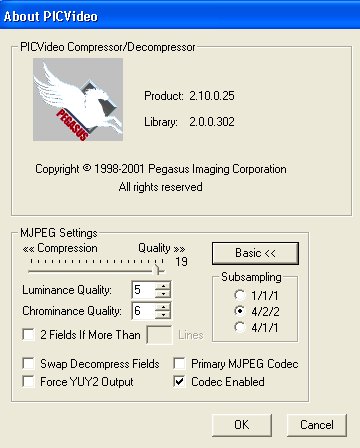

A quick question for Will Hay:
Under the advanced settings for the Pic Video MJPEG Codec what is the best of the following to use:
Subsampling
1/1/1?
4/2/2?
4/1/1?
Thanks in advance. -

Thankfully mine does'nt as I much prefer vdub to mmcOriginally Posted by andkiich
These are the settings I use:Originally Posted by pixel
Good luck

I think 1/1/1 subsampling with Picvideo is the best quality but uses more space and CPU time
