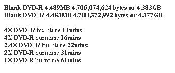

    Burning speeds (according to mrbass)
  4. Those numbers are for full discs. Not couting the lead in/out 1x DVD = 1350kb/s (1x CD = 150kb/s). So you can just do the math. As the above pic shows thou for me to burn a full disc on my Pioneer A05 takes ~15. And most of the discs I burn are full (ie. I use the highest video bitrate I can).

    You did 4.37GB DVD-R in 27mins or less or was it 2X DVD+R? I haven't come across 2X DVD+R so I haven't been able to test it. I've tested all those other speeds though. Obviously the burn times are less if you are burning 3.8GB or whatever. And yes all those times are approximations. Usually they are 14 mins 30 secs rather than 14 mins for example. It does take one minute longer to open and one minute longer to close when using DVD-R rather than DVD+R.
    Only reason I wrote that down was people posting stuff like "I burned at 4X but it took me 30mins..is this normal?"

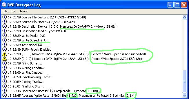

  10. Originally Posted by mrbass
    Weird but I got a 2xDVD+R burning one time instead of 2.4x
    (no buffer underrun!)
