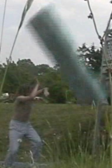

  7. LMFAO, I guess my posts turned into a big debate off topic for other users. Well, my story goes...I edited out the frames I didn't want with VirtualDub and frameserved into TMPGEnc, *MPEG-2 740X480, 2000 kbits, 29.97 fps, 32000 Hz 96 kbits* and a filesize of about 15.5 MB/Min doesn't look TOO bad. I just wish I knew a way to smooth the fast motions scenes because the motion has lines in it. I have attached a sample screenshot to illustrate what I am talking about...
  8. Your image does not appear, however the problem sounds like interlacing issues.
    DV is bottom field first, ensure you have that setting when you encode.
    Another possibility is that you are viewing this on a PC, this has a non-interlaced display. Try viewing it with PowerDVD, which has a built-in de-interlacer.
    If this is not suitable for your needs, you will have to encode to non-interlaced. Tmpgenc does have a de-interlace filter, but the ones in vdub or avisynth are probably better.

  14. Here's another small screenshot of the "lines" even with less motion.
    So is the solution for this a simple de-interlacing or what?
  15. Yah, I'm pretty sure that should work. I love Digital 8 instead of Hi8 since it's not interlaced

    Digital 8 is interlaced , at least most of them ive ever seen..
    nothing wrong with interlacing if you are going to view it on a TV , in fact de-interlacing interlaced video if its not going to be used on a Pc will make it look worse (a lot of the questions here are because people did exactly that) ..

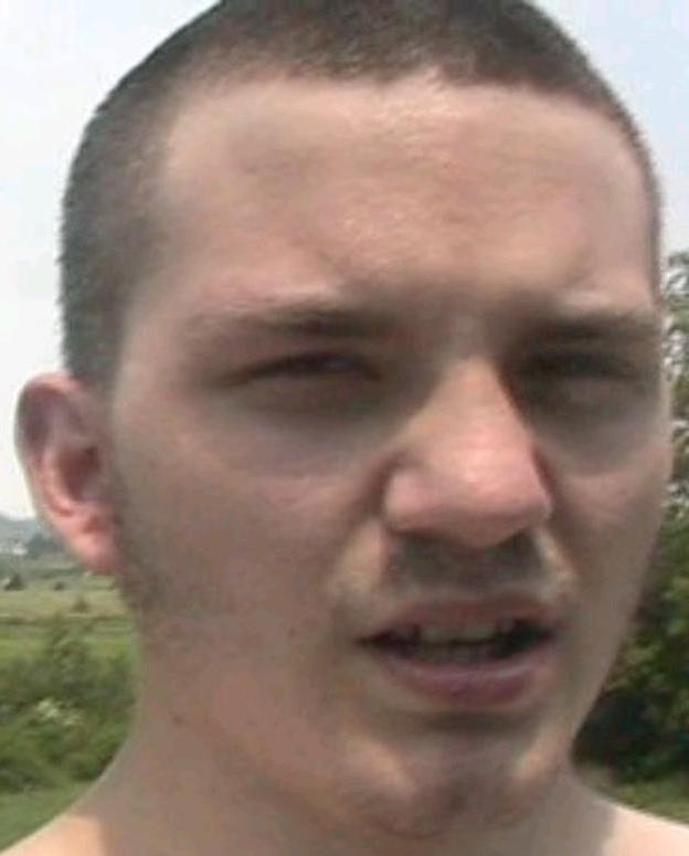

  22. WhackinCow, the quality is at a point in which I can live with. Thank you very much for guiding me through. Is there anything else I can do enhance it? Clear it up anymore? I'll talk to you on MSN, bud.
    Here's a screenshot of my face in XviD. It is my Digital Self, lmao. The Matrix has me...
  23. I'm WhackinCow, mind you, and, to make i sharper, next time make it encode so that the Motion Search Estimate is Ultra High (level 6).
  24. It was set as that by default, it encoded the previous one shown in that screenshot with Ultra High (6). Using a higher bitrate would do the trick but I do not want much higher filesize. I can live with what I have.
