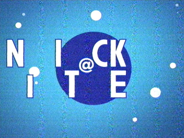

I bought a Leadtek Winfast Deluxe to play with and for the price, the card is great, my problem isn't the card, it's my signal. There were vertical lines on practically every channel. I then used composite through my VCR and the lines went away, but the picture was grainy. So, I tried using filters and different software, but the picture stayed grainy. Finally, I moved the card to another computer which was connected through a different cable and the picture was great. The problem is, that computer is 233 mhz and can't do anything. I can't move the more powerful computer there because it's at an inconvenient spot. Is there anything I can do to fix this? Thanks.

The card isn't on this computer right now, but luckily I did take a picture last night.
As for interlacing....uhhh lol no I don't know what it looks like, but if I was to take a good guess, that's not it -
Does this happen on all channels or just a few? It looks ( from first guess ) like a grounding issue ( the tuner assembly is not proerly grounded ) or a PCI/CPU interference pattern.
It happens on practically all the channels (~95%). I don't believe it's the card's tuner as on the other computer, I have the cable connected directly to the card and it gives a clear picture without the lines.

After spending hours trying to find my problem, I found it. I moved my computer to where the old computer was thinking it was the computer itself that was causing the problem. However, once I got it all set up and turned on, the picture was great. Now I thought it was weak reception. So I moved the computer back to it's original location and figured I would test it one last time. I plugged everything in and the picture was still grainy. Somehow I plugged a different cable into the actual TV and saw that the picture was clearer than before, so I tried connecting that to my card. The picture was better! While finishing up, I plugged in FM antenna into the card and guess what.....the lines appeared! Soo I can only use one or the other...oh well...I found the problem. -
