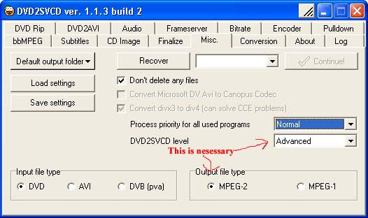

Now to get started. First open DVD2SVCD and go to the MISC TAB like this........
everything should look like they do in the picture above, except for the process priority used for all programs you can leave it like that or you can change it if you want, it really doesn't matter.

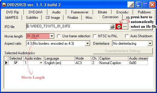

Now go to the conversion tab and well as you can see in the picture below, you can press the red square with a disk in it to autiomatically select the main movie in the DVD.

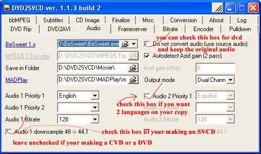

Well now you can head on over to the Audio TAB and well all the information you need to know on this tab is explained in the picture below.

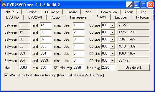

Now you should configure the Bitrate TAB Settings. Every movie has different lenghts and what not, but the one im making is approximatly 90 minutes. in my case im doing a VBR conversion. Although you can use CBR and use a bitrate of 2290. i mean only if your using 2 cds. but if your using 3 cds you can do this: split the file into 3 different parts of 30 minutes on each CD. now you will be able to use a video bitrate of about 3500. look at the picture below for details....

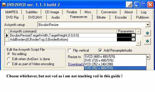

Now moving on to the Frame Server TABit is your choice to choos what project output you want to produce: be it as svcd, cvd, or DVD.

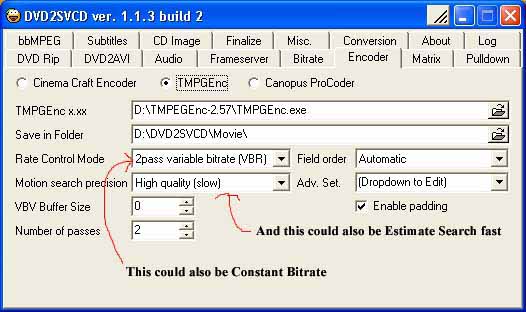

If you are using TMPGEnc 2.5 or whichever version this is what it should look like under the Encoder TAB

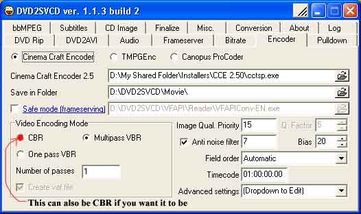

If you are using CCE 2.50, this is what it should look like under the Encoder TAB

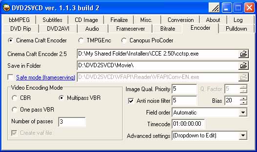

If you still want a better quality video output result, use 3 pass vbr using CCE like follows:

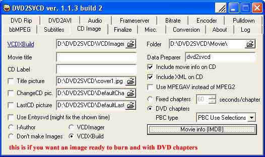

Now to finally, to Almost finish your conversion from a DVD to CVD, SVCD, or even to DVD, go to the CD Image TAB
