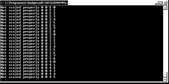

is this normal ?
SVCD2DVDMPG+ wrotes
******** Resampling audio from 44.1 KHz to 48 KHz
here the DOS Output (by besweet i thing) for Hours
not scaled properly 0 1 10 (etc.)
not scaled properly 0 1 11

AnonymousGuest

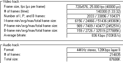

can you give me information on your input mpeg?
size, mpeg1 or mpeg2, length, width etc.
yf -
AnonymousGuest
filesize is aprox. 760MB
after using SVCD2DVDMPG the DVD has no sound.
i've no prob playing the original mpg -
you have the lastest version of svcd2dvdmpg+?
If yo demux the mp2 from the mpg with tmpgenc do you get a error then? If not you could try to run the mp2 through besweet by hand to see what it does.. -
AnonymousGuest
Hai Again,
shoud be the latest version cause of autoupdate.
no probs demuxing using tmpgenc
do i need more specialsoft ? eg. ssrc, 2lame ?
dont know how 2 use cmdline with besweet -
