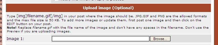

    Aug 2002
    England
    Hi
    How do I post pictures??
    So someone with a more experienced eye can tell me if they are or not.
    I know I can capture stills with powerDVD but how do I post them?
    Cheers
    Fozzee
  16. Lost Will Hay's Avatar
    Oct 2002
    Buggleskelly Railway St.
    Will
    tgpo, my real dad, told me to make a maximum of 5,806 posts on vcdhelp.com in one lifetime. So I have.

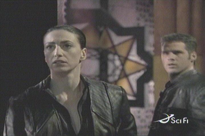

    Aug 2002
    England
    I can't get the image to show!
  18. Member
    Aug 2002
    England
    PowewDirector Pro I think this image is interlaced
