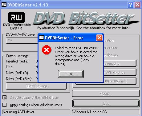

    The program recomended on the www.dvdplusrw.org website told me my burner was not compatable (sony) and I cannot run the program to convert my DVD+R (or DVD+RW) discs to DVD-ROM.

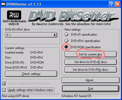

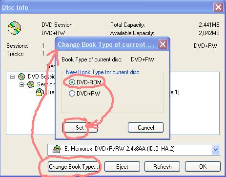

    I think you can change the booktype of a DVD+RW even AFTER BURNING
  9. I don't think I can chage the booktype in nero like that ... I've tried and the button doesn't exist. Maybe I didn't try it after I burned a DVD+RW and the other program you have. The error was for blank media on the other program.

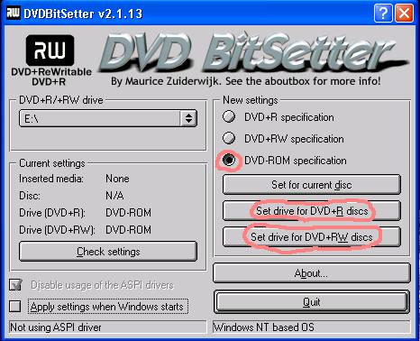

  10. The best thing if you set the drive to burn every single DVD in DVD-ROM specification
    Originally Posted by scottrwn98
    The Emmerson has never played any of my DVD+R's. Which sucks because this will be my primary DVD player soon. Grrr. Any suggestions?
    Yeah... I use RecordNow Max, had no problem in any way.
    That button exists if you put a DVD+RW in first
    If you prefer Nero make sure it is up to date
  11. Change of bitsetting/book type will only work if the drive's firmware support this feature. The ND-1100a firmware doesn't support this but you can flash it into a HP dvd300i which support change of book type on DVD+RW (DVD+R is still burnt as DVD-ROM by default).
