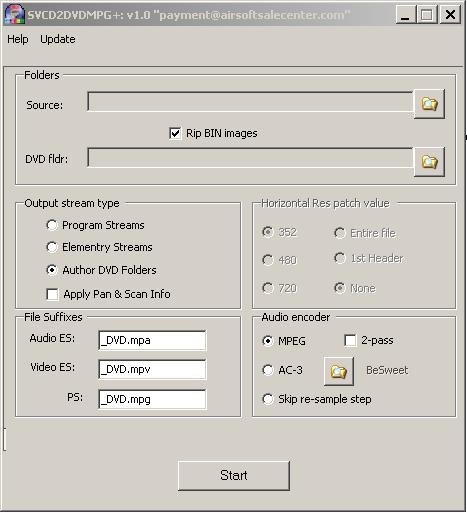

Here's a screenshot of what my program looks like. There are no buttons for moving to the other functions. What's wrong?

Guys,
The issue arises as you have non standards font/dpi settings in windows.
I have looked into it and the best solution I have come up with is to have the tabs at the top of the form. Now I, along with a lot of other users, wouldn't like to have to get used to that so I have added a GUI configuration menu item to let you chose whats best for you.
