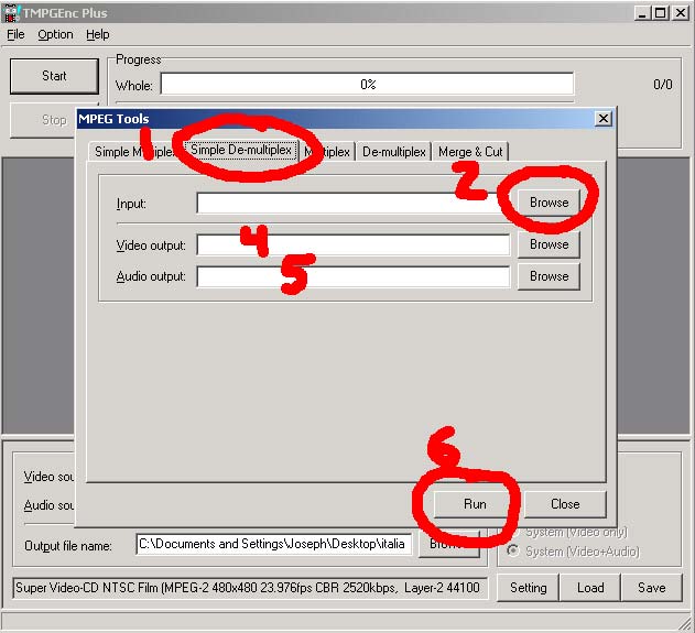

2. De-mux your audio and video file with TMPGEnc.
Go to file then MPG Tools.
Then click on Simple De-multiplex (1) then browse for your file (2). I usually rename my video and audio streams to indicate that they are the PAL video and PAL audio. I suggest you do the same to keep track (4) (5). Then run (6).
Time: < 4minutes.

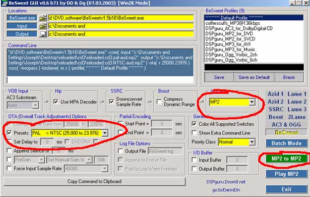

3. Convert audio file from PAL 25fps to NTSC 23.976fps.
Open BeSweet to complete this step. I use BeSweet with the GUI.
Check the Presets and select PAL -> NTSC (25.000 to 23.976). Select MP2. Then click MP2 to MP2 to start conversion.
Time: < 15 minutes.

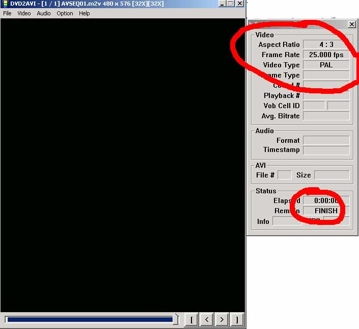

4. DVD2AVI frameserving?
I am not sure what frameserving is, but I see it all the time in the forums. I converted close to 10 different files without this step. It simply does not work. Video is cut off during the conversion process if this is not done (see step 5).

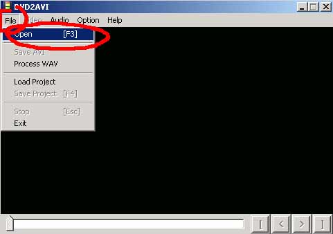

Open DVD2AVI. Click file, then open and locate your MPG PAL video file.
When file list pops up, make sure it is the correct file then click OK. You DVD2AVI program window will change size. Click on file then save project and choose a filename.
What happens here is pretty quick. DVD2AVI analyzes the file and the slider at the bottom moves to the right. At the same time a window appears at the right that tell you about the video file. When completed it will say FINISHED. You should now have a real small file with a .d2v extension. Save this file for later.

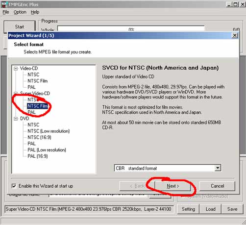

Open TMPGEnc.

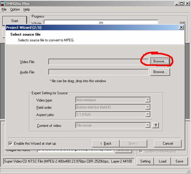

I use the WIZARD, select NTSC Film, then click next.

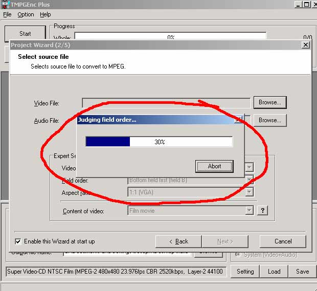

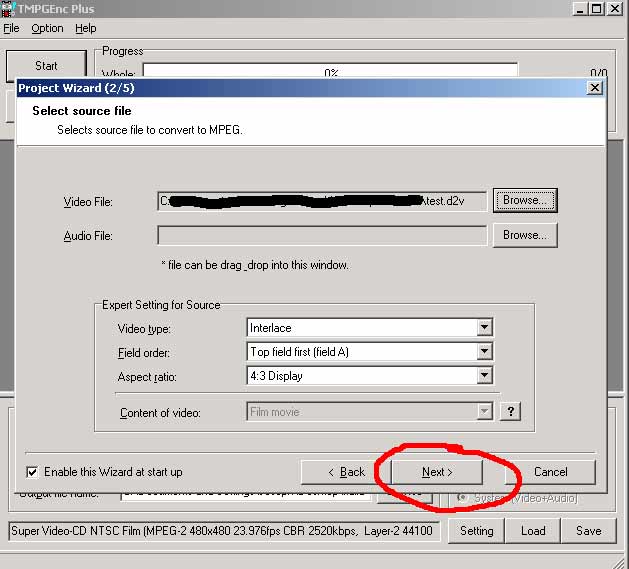

Click on browse under video file and locate the d2v file from step 4.
When you click OK you get a screen that looks like this, judging the field order.
I keep all the defaults and click next.

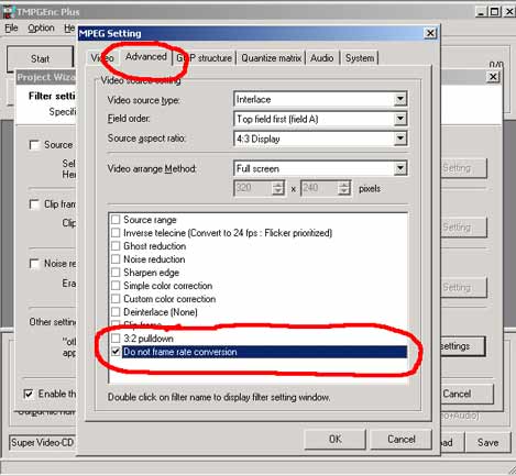

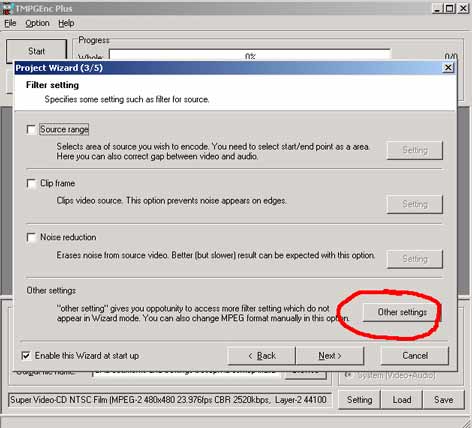

Click on Other Settings.

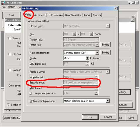

Under the Video tab make sure the Encode mode is 3:2 pulldown playback.
Under the advanced tab make sure Do not frame rate conversion is selected. Click OK then next to move to step 4 of the wizard.

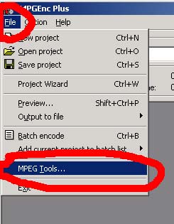

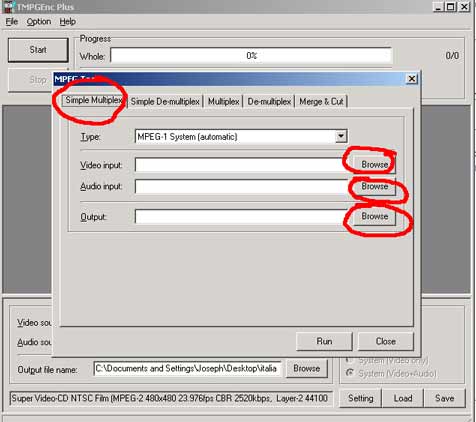

6. Simple Multiplex the video and audio.
Click on file then MPEG Tools.
Click on the Simple Multiplax tab, then browse for your NTSC video and audio files. Type is determined automatically. Click run and you are all done.
Time: < 4 minutes.
