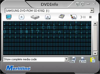

    @MovieGeek, yea, that really does suck...talk about a waste of time...I thought I could rely on these Verbatim DVD-R's...but being that these dirty bastards had BOTH MMC AND CMC manufacturer ID's in the same spindle leads me to believe exactly what you are saying...that Verbatim thinks we're just some stupid shits...but I don't play that crap..and they can take those 45 disks and shove them up their ass.....because I now have 75 fresh Philips DVD+R's and didn't pay a single cent for any of them.
    Funny thing is that I also went to Best Buy afterwards and noticed that NOW they have the DVD-R's that say "DATA LIFE" WITHOUT the PLUS on the spindle..and the media looks MUCH CHEAPER..it doesn't have that nice gloss clear coat on the top like the other ones.....I guess Verbatim decided to put those CMC disks in a DATA LIFE PLUS package...I have no clue what they tried to pull...but I'll never purchase another disk from them again....screw em'!
    @Bhola, go to the tools section of this site and download DVDINFO and you can check your manufacturer id's there. I'd be willing to bet that the DVD+R's...like the DVD+R's I have from Verbatim will say MMC which is apparently a much higher quality disk...but who knows now with the crap Verbatim is pulling......as far as i'm concerned i'm sticking with what works...and Verbatim definitely doesn't.

    @defense:
    The three letter abbreviation for Mitsubishi Chemical Corporation is MCC, not MMC.
    Also, all Mitsubishi/Verbatim CD-R/DVD-R's made in Taiwan are made at the CMC Magnetics Corporation manufacturing plant, regardless of whether they have the CMC or MCC manufacturer ID.
    If you want discs made at a dedicated MCC plant, look for Verbatims made in Singapore.

    @terminovelocd, I hadn't checked the id since the first disk I tested weeks ago when I purchased the Verbatim disks. The Id was NOT CMC...and started with an "M"...if it was MMC OR MCC OR MCM I really don't know...I just know it didn't have that CMC...MAG crap that the CMC disks have.
    Your reply is very interesting however, because this may explain why the Verbatim DVD-R disks I purchased months earlier had NO problems. They may of been MCC disks with a CMC manufacturer ID. I'm not sure..all I can say for a fact is that THIRTY VERBATIM DVD-R's out of 30...OR 100% BURNED PERFECTLY and played PERFECTLY..all the way through...those have CMC manufacturer ID....but damn near EVERYONE of these OFFICE DEPOT two for ONE Verbatim disks have some type of issue..whether it is bad enough to stop the burning process or noticed during playback.
    Something is defintely wrong there...and as far as "wanting" Verbatim disks....I guess you didn't read my post fully....I wouldn't take Verbatim disks if you gave them to me...not from Singapore or PooraSing..or anywhere else....as I said...SCREW VERBATIM!

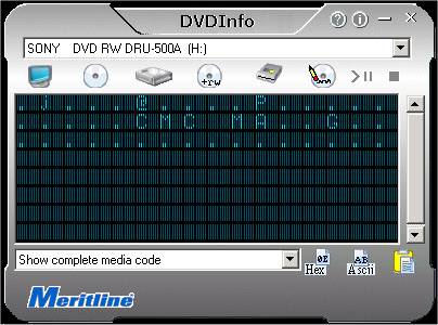

    Well, I've got a spindle of 25 Verbatim DataLifePlus 2.4x DVD+R with the following media code:
    Burned with Nero 5.5.10.28 and Sony DRU500A (1f).
    Plays like a dream, all the way to the end. I can jump chapters any which way without a problem.
    Must be a bad batch around.

    rhegedus......
    what program is that a screen shot of??
    thanks

    Member rhegedus's Avatar
    on the jazz
    Posts
    3,171
    Regards,
    Rob
