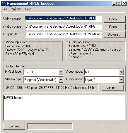

Ok, did a pal to ntsc convert with MainConcept Encoder, same file as the one I converted with Vegas 4.0. I'll burn it and let you know how it goes.
GTZ -
GTZGuest
Success!!!
No stuttering video after doing the Pal to NTSC conversion with MainConceptMPEG Encoder, which I might add is super easy to use.
Plays fine on my Apex 1100W, I'll have a friend test it out on his Toshiba that doesn't play anything but NTSC DVD's and will report back tomorrow night.
Regards,
GTZ
P.S. Many thanks to Honestsoul for sharing what works for him
P.P.S Here's a screen of MainConceptMPEG Encoder.....simple.
GTZ

Success!!!
Regards,
GTZ
