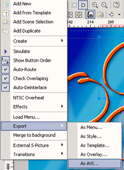

    1. Make a Menu with frames and a background using DVD-Lab. Try to stay within the inner dotted line (title safe area) if you want to make xtra sure it wont clip on your tv.
    2. Export the Menu as an avi "Background.avi". You need only 1 frame. The size should be 720 x 540. This size makes it easier to place your clips. We will resize latter to 720 x 480.

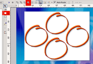

    1. Place a White rectangle behind the frames, and move it to back. Also, if you set the drop shadow of the frames to none, it will be easier to edit.
    2. Export again. This time as an Overlay "Overlay.png". This removes the background.

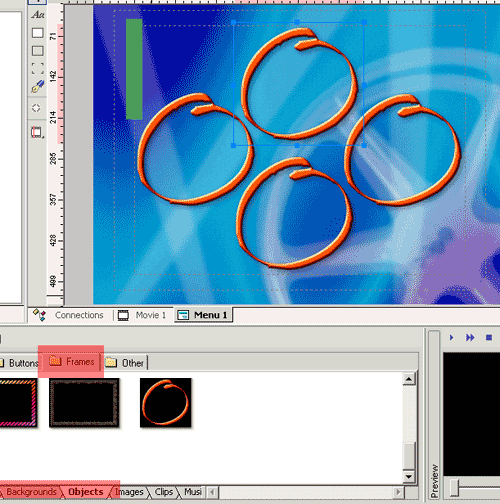

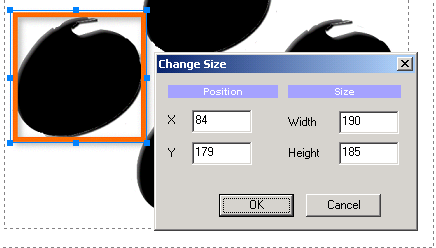

    [*]Easy Placement of Clips
    Draw some frames around your black spots in the 2nd menu. Don't let them overlap the other black spots. Right click on them to check the size and position. We will use these numbers to place the clips on the menu.

    Clip1 = Clip1.crop(110,0,-110,0).LanczosResize(190, 185)
    Menu = Layer(Menu, Clip1, "add", 255, 78, 178)
    Clip2 = Clip2.crop(110,0,-110,0).LanczosResize(190, 185)
    Menu = Layer(Menu, Clip2, "add", 255, 270, 67)
    Clip3 = Clip3.crop(110,0,-110,0).LanczosResize(190, 185)
    Menu = Layer(Menu, Clip3, "add", 255, 448, 182)
    Clip4 = Clip4.crop(110,0,-110,0).LanczosResize(190, 185)
    Menu = Layer(Menu, Clip4, "add", 255, 257, 299)

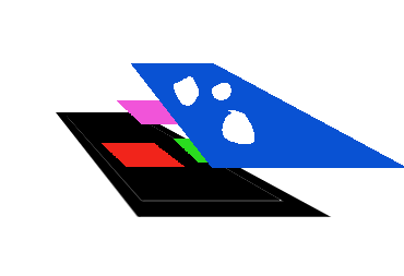

    # 5 Mask & Place the Background
    BackGround = Mask(BackGround,Mask)
    Layer(Menu, BackGround, "add", 255, 0, 0)
    # 6 Resize to D1
    BilinearResize(720, 480)
    Here is what it does:
    1. Load the files we exported from DVD-Lab and put them in a common color format
    2. Load the clips, grab 1800 frames (1 min @ 30fps) from different starting frames, and put them in a common color format. You can use VirtualDub to find the starting frame you want.
    3. Start the menu as a 1 min blank clip with the same fps, size, etc. as our background
    4. Crop the clips and size them to our frames. Crop 1st because we have rectangle clips and need more square, this way resize doesn't distort the aspect too much. Layer the clips on the Menu we are building. Use the size and placement from your frames in "4) Easy Placement of Clips".
    5. Mask the Background. This makes the corresponding black parts transparent (inside our frames). Layer the background over our clips. Their centers will show thru. Here is a (lame) picture of the blank menu, the clips, and the masked background.

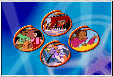

    [*]Open the "menu.avs" script in virtual dub and this is what you get.
    [*]Save it in VirtualDub (or frameserve) , and encode an Mpeg with your favorite encoder.[/list:493dd92fc2]

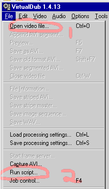

  13. You don't actually need the location if they are in the same directory as the avs file.
    Sorry I didn't get back sooner, but I have to actually work to support my DVD habit.
    I think your problem is "sylia script error".
    Select 1) "Open Video File" not 2) "Run Script" to open the avs file.
  14. Im having a problem running the avs thru VirtualDub the first time i use this guide. Since then, I indicate the location of the avi. Now it runs smooth and works fine with VDub. Just run VDub, select "Open video file" - look for the avs file that uve just created. Then save the file.
  15. It works!!!
    The problem was that I ran script with Open ideo file command at the fist time and it didn't work (I didn't read message carefully), so I tried with command Run script. So yesterday I did as you told me, and the problem was, that the mask.avi wasn't the right size, so i did the mask.avi file again and it worked.
    Thank you for your help agan!
    Robert
    # 6 Resize to D1
    Also when previewing in v.dub the clip does not loop should it do so??
    hope you can help
