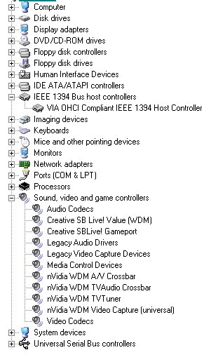

I have 3 listed network adapters for some reason. One is my regular network adapter 3COM card. My 1394 card is listed there also as a network card. The third is a Mac Bridge Miniport...?
1394 card device #13 IRQ-17
3com card device #10 IRQ-18
Snd card device #12 IRQ-16
Don't see an ! (exclamation points) in devise mnger...
I'm sure it's something simple.Don't give in to DVD2ONE, that leads to the dark side. -
Marco,
Looks ok, SB drivers ometimes do strange things though.... But, Did you start with a fresh OS? Or was this the same OS install and you had an other cap card? It's possible you may have a codec issue. Are you running PowerVCR? -
I uninstalled the Soundblaster card & the Nvidia drivers. I rebooted and let XP reinstall the Sound card BUT, didn't let it install the Nvidia WDM drivers. Tried 2 different cap software and that seemed to do it.
Old OS.
No, not running power VCR.Don't give in to DVD2ONE, that leads to the dark side. -
