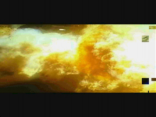

  6. I previewed the script in Media Player 6.4 and Windows Media Player 9.0. Both also show the video flawed. Here's a screen shot from ATI File Player that i captured.. (hope it works)
  7. Wow.. it finally worked.. What's stranger is that that capture above looks 'ok' respects sizing.. but when i go thru the complete process, forget it.. doesn't look 'ok'.. (btw, i resized that shot above to 320x240).

    i just dowloaded Windows Media Player Series 9.0 and imported the basic avisynth script, i.e., mpeg2source("C\path to .d2v"), and all that played was a 'small' box in the middle of WMP's screen.. WITH cutoff and pixelation..
