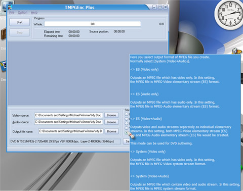

    how can i use these to put on a dvd? or is there a setting that i can get to output just 1 file with video and audio together?
  2. You need to author the m2v (video) and mp2 (adudio) files to make a DVD (see the author section to the left). Popular authoring programs include: DVD Lab, TMPGenc author, DVD Maestro, Ulead, etc.
    Most authoring programs want you to author from the elemetary streams (ie seperate video and audio, also subs if desired). Some programs can author from the combined/muxed MPEG2 file.
    TMPGenc can be set to output either ES (seperate files) or PS (joined files) encoded MPEGs. When you run TMPGenc look in the bottom right (just above the settings|load|save buttons). Here you can choose: video only, audio only, video + audio, both video and audio, etc.
    Also note that mp2 (mpeg1 layer 2) audio is NOT supported by the DVD standard in NTSC nations (it's part of the standard in PAL nations). However, most DVD players will play it anyway. If you're will not (or you just want to be extra safe) you should convert the mp2 to either ac3 or PCM (ie. wav). PCM is uncompress and takes up a huge amount of space so I suggest ac3:

    If you set stream type to System(Video+Audio) then it should produce an mpg file instead of separate m2v & mp2 files.

    Both Vejita-sama and curritch are correct change output in last window of wizard [if using wizard or in main screen if not] to produce a single mpg2 file. This file still must be authored to be useful just as the m2v and mp2 must be.
    The check box near my pointer is used for separate output files uncheck to obtain 1 (video+audio) mpg2 file
