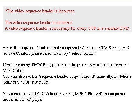

tried that..got this...
also tried running it with entire file instead of just first headers--same deal--MF2 tries to convert it. HELP! -

If TMPG DVD AUTHOR gives you an GOP/Header error then that is the source whihc is at fault. My program doesn't touch these. What you are doing when you reencode in the TMPGEnc encoder is basically turning the duff source file into a DVD compliant one AND you are rectifieing the GOP/Header issues. Thats why it works.
