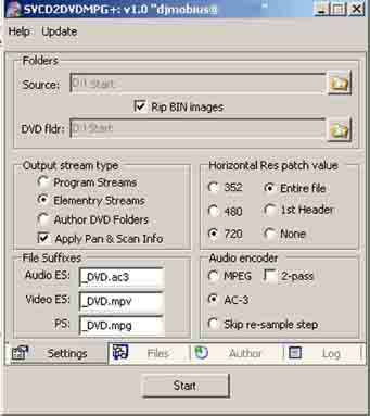

[img]https://www.videohelp.com/forum/images/guides/p552187/c:\s2dm.jpg[img]https://www.videohelp.com/forum/images/guides/p552187/

This is embarrassing. The image contained the SVCD2DVDMPG+ settings.
They are:
Source and DVD Folders = D;\Start
Output Stream Type: Elementry Streams and Apply Pan & Scan Info checked
Horizontal Res Patch Value: 720 and Entire file checked
Audio Encoder: AC-3 checked
