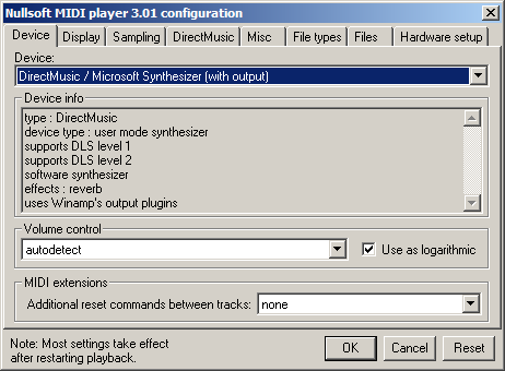

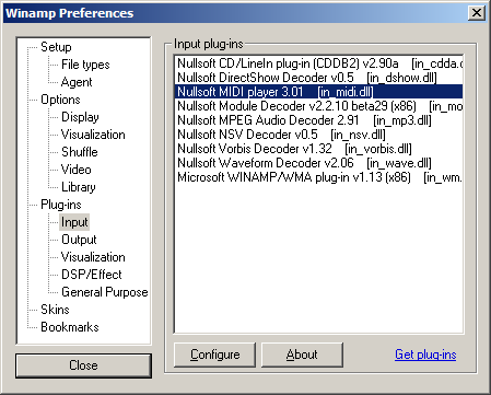

    Perplexed (as I have done this before) it seems that the newest version of Winamp has a much updated MIDI component since I last had a look at it. For me, these following settings allowed me to save the MIDI as a WAV file. If it works properly, you SHOULDN'T hear the midi as it is playing as it is being channelled into the disk writer as a wave file.
    The settings as pictures:
    Ctrl+P for preferences and then click on the Input --> MIDI as below:
    Click on configuration and then change the default to the below:

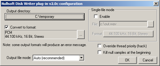

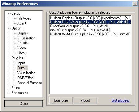

    And of course, you must of your output plugin changed to the disk writer as explained previously but here are some pictures too:
