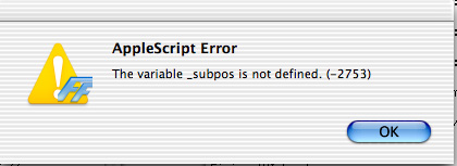

    Hello Major,
    The first time I want to play a .VOB file, it works fine.
    But sometimes I have this error when I want to play the .VOB file after clicking on different tabs 'audio', 'Tools', ...
    On previous releases, i never got this problem.
    Toche (0.0.7a registered)
  2. In 0.0.7 I rewrote almost half of the code, so it's possible there are some bugs, though it should be easy to fix them if you can help me reproduce the error. Does it appear only with VOBs? Clicking on "Preview" (filters tab) also gives the same result?
  3. OK, I think I found it. Happened with ffmpeg mpeg-4 selected, fixed it for release in next subversion.

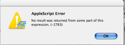

    Hello,
    I've made few tests. First i choose a VOB file then,
    1) I choose a xxxx (mencoder) setting, next i click on the filters tab and if i push the 'play' button, it works fine
    2) I choose a xxxx (ffmpeg) setting, next i click on the filters tab and if i push the 'play' button, i got the error (see above)
    3) I choose a xxxx (mpeg2enc) setting, next i click on the filters tab and if i push the 'play' button, i got this error:
    I know it's a minor bug, but it's a bit confusing...
    Thanks for your quick support!
    Toche

  7. Originally Posted by Toche
    Fixed and will be released in 0.0.7b.
