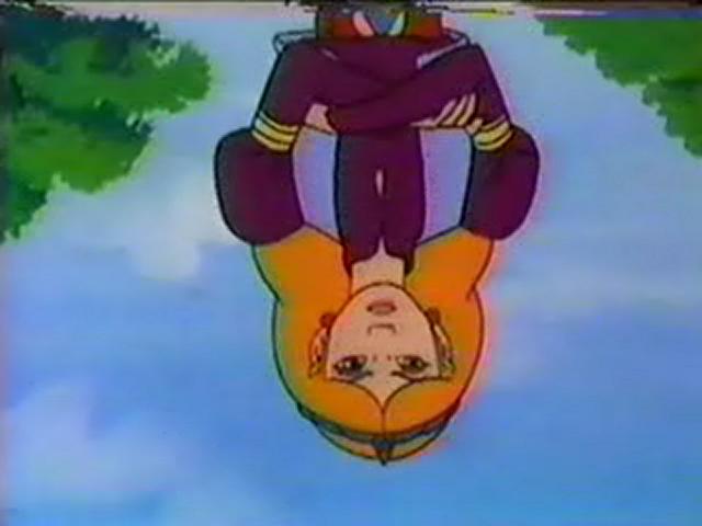

  1. I downloaded some old Legend of Zelda episodes, and everything was great up to episode 8!
    The first 8 are .mpg, while the last 5 are .avi...
    When I play the .avi's, the video is UPSIDE-DOWN!!
    Does anyone know how to un-reverse the image? Is there an encoder that can flip it back to normal?

    ACTUALLY...the very same thing happened to me. I used AVICodec: http://avicodec.duby.info/
    This is a good one too: GSpot
    http://www.headbands.com/gspot/
    I found out that I lacked the correct CODEC on my file for these type of .AVI files.....I think they were old school DIVX. I got my new CODEC and VOILA...problem solved!!! Hope that helps.

    those files are probably encoded with xvid
    there is an option in the xvid codec to flip video
  5. TY natebetween, I found they are DivX 3... I have Nimo's Codec Pack installed, but I guess using DivX 4 to play all DivX 3 is the problem... I'll have to change something...

  6. Damn it! I just watched one, right side up, and when WMP ( 8 ) went to the next one, upside down agian... then I tried to play the first one, to see if that could fix it, nope, upside down agian!!!
    AHHHHHHHHHHH!!!!!!!!!!!

    Nimo does suck, as evidenced by your problem.
    Specificically, you are not using the DivX 3.11 codec to play the DivX 3.11 file. That's your problem. Just because it's installed doesn't mean you are actually using it to render video.
    Confused? It get's muuuuuch worse. You are only playing a video, wait until you try and encode or convert one.
    As to fixing your problem: Try going into the FFDShow setup and select flip video. You will have to do this manually for different DivX issues. Joys of using WMP.
    Personally I reccomend Formatting and re-installing your OS. Nimo doesn't remove itself very well. Install DivX 5, XviD latest build, FFDSHow latest build, MPEG2 codec, and assorted audio codecs including AC5.1. That's all you need. Don't install WMP9 either, or you will have problems with old DivX (audio codec problems with hacked codecs).

  11. You say I'll have problems encoding with Nimo... I have been encodeing for a year now, from AVI to MPG, and from AVI (extreamly high bitrate) to AVI (average bitrate)... Never had a problem... the only problem ever was with this latest thing, and it's because I didn't have the DivX 3.11 codec...
