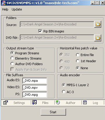

2. Next we are going to do the SECOND step in the preparation of the VCD'S. We are going to use SVCD2DVDMPG+ to do the next step. Open the program.
You need to place all of the (Newly) re-encoded VCD'S into a folder all by them selves. The reason for this is because this program uses all of the .mpg's in the folder. On the SOURCE choose the folder that you created. You can use the same Folder for the DVD FLDR. Next you only need to click on (Program Streams) if you want to use ANOTHER program for the DVD Menu's. This program at this time does not make Menu's but it will do the final out put folders for DVD.
If you do not care about Menu's then simply choose (Author DVD Folder) then skip to step (4).

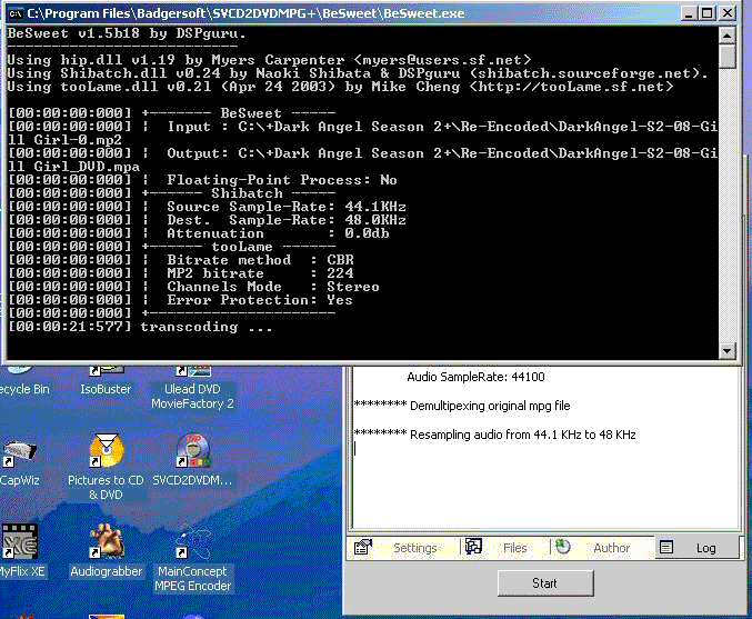

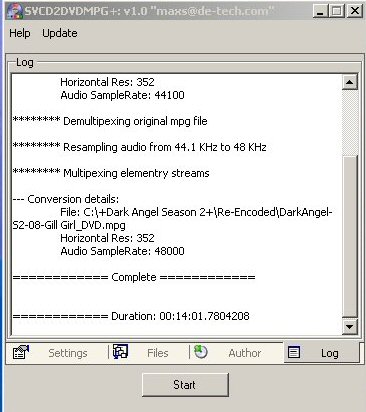

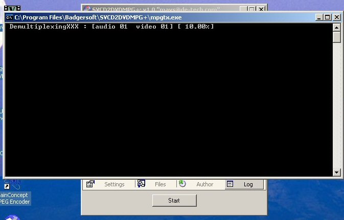

When you click on start you will get a screen that looks like the one above. The Encoding process is started. What is happening is that this program is converting the audio of the VCD to 48000 Hz DVD Compliant.
The actual Audio Transcoding is done with BeSweet and is a very good quality.
When this part of the conversion is done you will see a screen similar to the one above with the results in a log file. Simply close this window and move to the next step. (NOTEWhen this program is done you will see on your drive in the folder that you made 2 mpg's of the same name with the exception of _DVD. The _DVD files are the newly re-encoded files and you can delete the others. ((Keep the _DVD files and kill the rest)

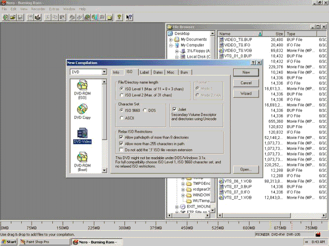

4. In this final step we are going to use Nero Burning Rom to Burn the DVD-R Disc. Open Nero.........Choose New Compilation and then choose DVD-VIDEO. You can leave all of the setting at default.

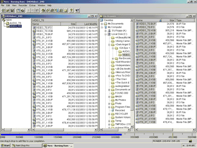

Next click on New and brows to the folder with the final DVD output that TMPGEnc DVD Author created. You will see to folders in the final output folder. One folder is called AUDIO_TS and the other is called VIDEO_TS. the Audio folder is always empty. Next on the far left side........CLICK on the VIDEO_TS folder so that the second windows from the left is open. In The 3rd windows find the VIDEO_TS folder that was created and click on it. When you do this the 4th windows
will show what is inside. Choose all of the files by ctl A or edit select all.
When you have them all selected..........Drag them all into the 2nd windows.
If you have done this right then your screen will look like the one below.
Now all you need to do is to write the DVD. I have a Pioneer DVR 105 that writes at 4X and it only takes about 15 min to write a full DVD.
