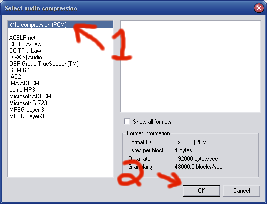

STEP 1 – Open your source file in Virtualdub, and set Audio to “Full Processing Mode”.
-For “Compression” select PCM

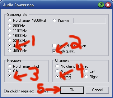

-For “Conversion”, select the following.
Under “File” select “Save as WAV”.

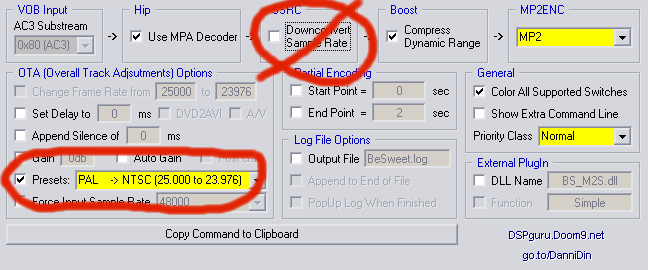

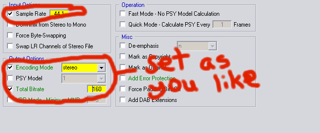

STEP 2 – Use BeSweet GUI to convert your WAV file to MP2. We already changed the sample rate to 44.1 so make sure “Downconvert Sample Rate” is UNCHECKED. Use the “PAL->NTSC (25.000 to 23.976)” preset in the OTA section. After BeSweet converts your WAV to MP2 your audio is done.
AUDIO NOTES –
-BeSweet setup – there’s about 2000 settings in BeSweet. If you don’t know what they mean don’t touch them. Make sure you set “tooLAME” to your desired “Encoding Mode” and “Bitrate”.
-AC3 audio requires an extra step than described here. When you extract AC3 audio the sample rate remains the same ( 48 ). If you try to change the sample and frame rates at the same time with besweet, it won’t work. So you have to go from AC3 to wave (downconvert 48->44.1) and then WAV to MP2 (25->23.976).

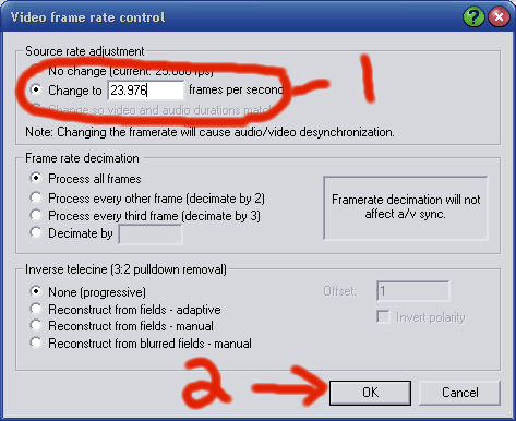

STEP 1 - Again, open your source file in Virtualdub. Under “Audio” select “No Audio”. Under “Video” select “Full Processing Mode”, then “Frame Rate” as follows.

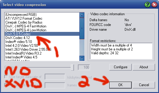

Under “Compression”, pick your favorite NON XVID compression (Divx 5.x or whatever – just make sure the bitrate is set to 2600 or higher).
NOTE – Even if your source is XVID, you HAVE to change it to another compression scheme – XVID is problematic frameserving.

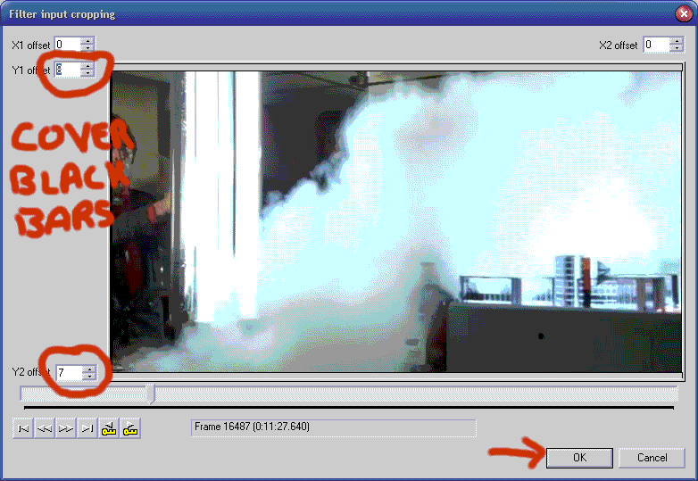

If your source is letterboxed, also add a "Null Transform" filter and crop out the black bars - we'll put them back in later. NOTE **, see below
The select “Save as AVI”. Your resulting AVI will have no sound (it would lose synch) and will be at the proper framerate. This can take some time.

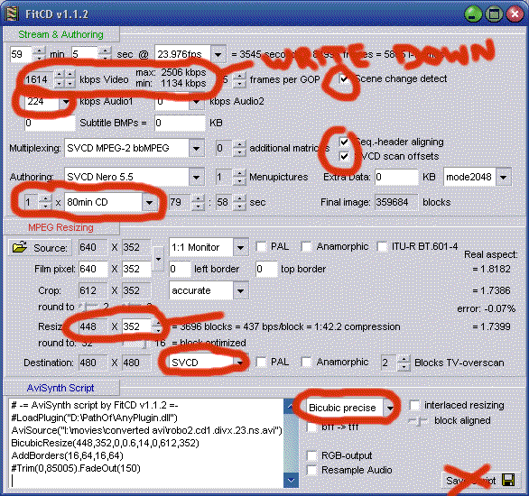

STEP 2 – Open FITCD and select your new AVI. Decide how many CD’s you want it to be on. Leave the Audio kbps at 224. Check blocks as you see below.

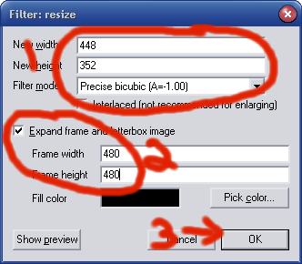

Add a “Resize” filter under video and set the new height and width to what FITCD says. Make other settings as you see below.
NOTE ** If you have a true PAL source @ 480x576 just resize here, 448x448, letterbox 480x480 - whether the source is FS or WS. This will provide the correct aspect ratio.
Then crop out the black bars above and below.

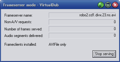

With that done. Start your Frame Server (under File).
NOTE – You must have run “auxsetup” and enabled the frame server.

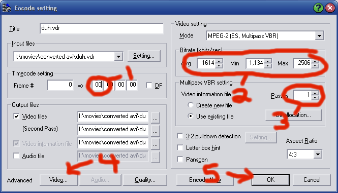

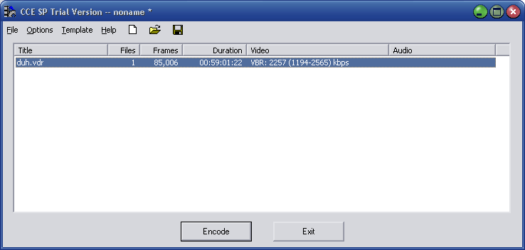

STEP 4 – Launch your MPEG2 encoder (from here on directions are for CCE). Right click in the white area and select your VDR.
Right click on it to edit. Set bitrate as per FITCD and determine how many passes you want to make (1 is sufficient). Set timecode to 00.

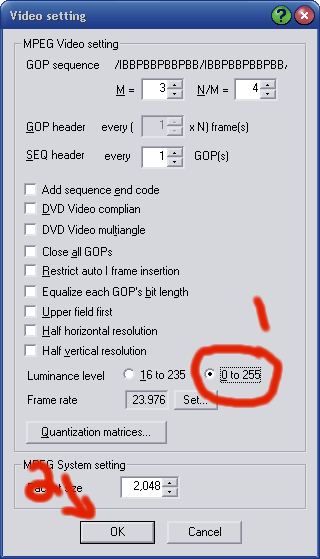

Click “Video” and set “Luminence” to 0 to 255 and click “OK”.
Now you’re ready to encode. So click “Encode”. Depending on the number of passes you picked, this could take a while.

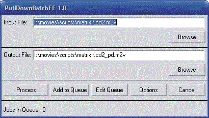

****NEW***** STEP 5 - Use Pulldown.exe (GUI version if you like) on you newly encoded video file.
NOTE - Your input video here will be .MPV unless you changed CCE’s defaults.

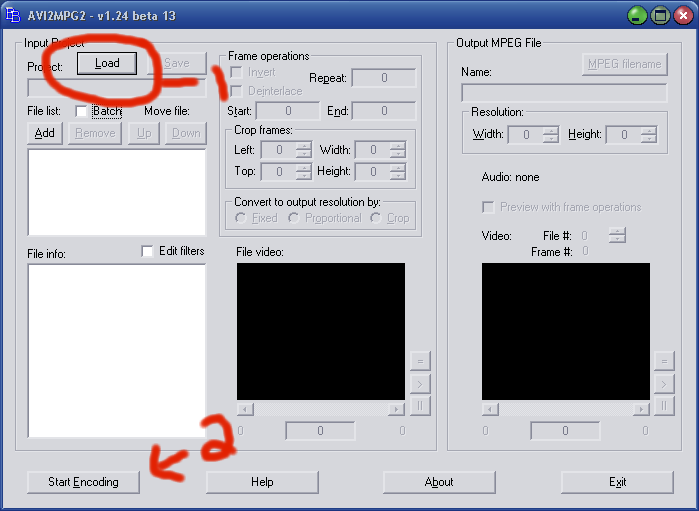

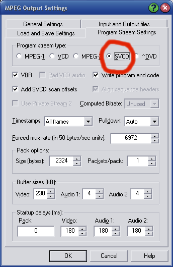

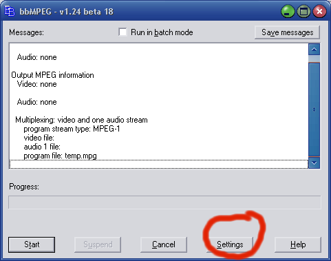

STEP1 – Open BBMEG. If you’re using XP, you have to click “Load” then “Cancel” or the program will crash. Next click “Start Encoding”,
then “Settings”
Select your input and output files.
NOTE Make sure your input video file is the output from pulldown.exe.

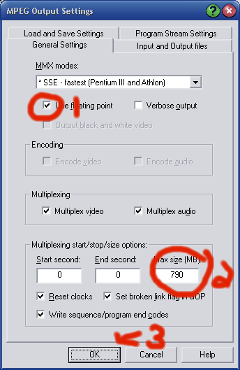

Make these settings.
Then these.
NOTE – Max size – if you’re creating a 2 or more CD SVCD, you can play with the # here. Don’t raise it above 800ish. For one CD don’t even mess with it. You have to hit TAB after entering a value here to get the check boxes below to appear.
