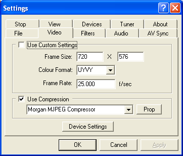

    2) Start Virtual VCR. Click the settings button, and select where you want the captured file to be saved to. Next hit the video tab:

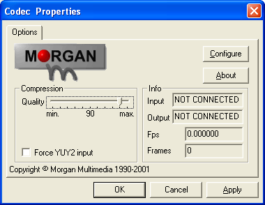

    My system handles a 720x576 capture perfectly. If you have a lower-end system and you find you are getting dropped frames, lower the resolution to 352x576/480 (depending whether you are PAL or NTSC, 480 for NTSC, 576 for PAL). Now choose the "Prop" button, and change the compression quality to 90. I find this provides excellent results at reasonable filesizes (about 8GB for 50 minutes).
    Leave the configure button alone, the default settings are fine. Close this window and click device settings:

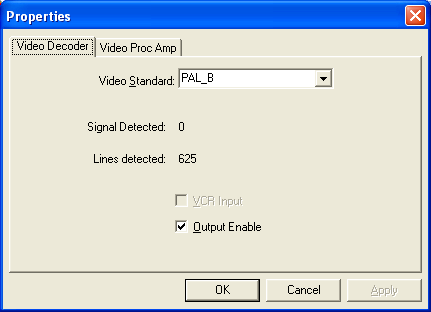

    If you are a PAL user make sure the input type is set to PAL, and if you use NTSC make sure its set to NTSC. Failure to do so will result in either a cut off image (set to NTSC when it should be PAL) or garbage at the bottom of the screen (PAL when it should be NTSC).

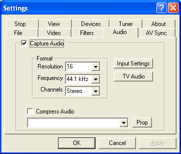

    Now click the audio tab:
    Those may or may not be the default settings, but they work fine for me.

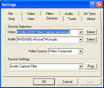

    Now click the devices tab:
    I'm capturing through composite from my VCR, so I select composite as the video source. If you are using a different type of connection, select it instead. Also make sure the Nvidia WDM driver is selected for video and your soundcard driver selected for audio.

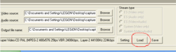

    4) Open TMPGEnc. Now you must choose which format you want to convert to? Do you want SVCD, CVD or VCD? (You could also encode to DVD, but as I don't own a DVD burner I've never done this, and thus can't guide you on it. Refer to another guide if you want to create a DVD). Anyway, load the relevant template:
    5) Select the appropriate template based on whether you live in a PAL or NTSC territory and what format you want to convert to. For this guide I will use SVCD/CVD as the example, but I will explain VCD further down.

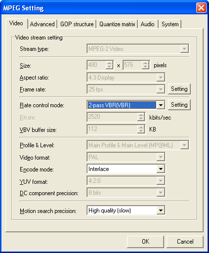

    6) Select 2-pass VBR in the rate control mode box, then hit the settings button next to it. Use a bitrate calculator to determine the max, average and minimum bitrate you should use.
    Interlace should be the default encode mode, so leave it as is. (You may wonder why I'm deinterlacing the source only to re-encode it with interlacing again... the answer is simple: I found unless I deinterlaced first, the outputted MPEG will have horrible motion blur. But feel free to experiment without deinterlacing, if you don't notice the motion blur you need not deinterlace in Virtualdub, cutting down the encode time somewhat).
    Motion search precision is somewhat iffy. You should experiment with this, see if you can really notice a difference between them. However some advice: Do not choose "highest", it is a waste of time. I advise you to select either high or motion search estimate.
    All other settings can be left at default, EXCEPT for the resolution in the event you want to make a CVD. In this case, right click "Size:" near the top, and choose unlock. This will allow you to edit the greyed out standard SVCD res. Change it to 352x576/480 for CVD.
