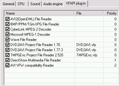

Try the environmental settings in Tmpgenc. Adjust the priorities.

I believe pijetro is referring to the DirectShow filter under OPTION | ENVIRONMENTAL SETTINGS | VFAPI PLUGIN Tab. Bump the priority of the DirectShow filter up, so that it is at the top of the list (usually a 2 or higher will do it), and try a small clip to see if it clears up your black video problem.Impossible to see the future is. The Dark Side clouds everything... -

Yes same D2V as yesterday. Using AVISynth 2.08 and DVD2AVI 1.76. Some changes though (see below).
I'll try the ENVIRONMENT SETTINGS tonight as well as loading the D2V straight in to TMPEGenc. I think the D2V is good though. Remember I can load my AVS file in to Windows Media Player 6.4 and it plays fine, (thought the aspect ratio is off just like you said).
Sytem changes: I noticed I had AViSynth version 2.08 and 2.5 on my computer so I uninstalled 2.08 & 2.5 and then reinstalled 2.08, I then moved the MPEG2DEC.DLL to the AVISynth plugin directory. Other changes: I noticed I had Gordian Knot version .28.5 so I uninstalled it and then installed .27 and that solved my D2V/Gordian Knot loading problem. Maybe this software uninstall/install is causing problems with Avisynth? I made sure not to reinstall AVISynth as part of the Gordian Knot rip pack.
What about the priority of READAVS.DLL in TMPEGEnc?

rockstar70, if you installed AVISynth as part of a package, you may have multiple copies of MPEG2DEC.DLL on your system. Use the START | FIND tool to search your entire computer. They are often found in your SYSTEM, or SYSTEM32 directory. You should have only the copy in your PLUGIN directory. You can use either version 2.08, or 2.5 of AVISynth. I finally switched to 2.5 in full, since it seems to be stable now. You will need to upgrade to MPEG2DEC3 if you want to go that route though.
Don't worry about the .AVS plugin. You can always up the priority, see if it helps, and if not, just bump it back down again. Encode a small piece of your clip using the Source Range filter on the Advanced tab.

DJRumpy,
You were right. It was the DirectShow filter priority!

I have noticed in my environment settings that AviSynth doesn’t show up like it does in the above pictures... is this my problem or something else?

Definetly a problem that AviSynth doesn't show up in your environmental settings. Did you ever install ReadAVS.dll (READAVS VFAPI plug-in)? If you didn't install it and need the file, let me know and I'll e-mail it to you. I had a hard time finding it on the net. The links to ReadAVS.dll on this site and doom's site are bad. I finally found it on a Spanish site.
Go to Luke's Video web site for install instructions. www.lukesvideo.com Under Contents choose Software. On the Software page it explains ReadAVS installation near the bottom.

i have used DVD2AVI 176 and 177 and get the same error... i havent manually installed ReadAVS.dll but i dont remember seeing that one on instructions... where does it go??? windows/system32 or in the TMPGE folder?

What's your e-mail? If you don't feel comfortable posting it here send me an e-mail at rockstar70@socal.rr.com and I'll send you the necessary ReadAVS zip file.
You can put ReadAVS.dll in any folder on your system. Unzip the folder I'll send you. Then you open the *.reg folder in notepad, then enter the path to ReadAVS.dll. Save the new file and then click on the file to update the registry with the location of ReadAVS.dll. It's simple.
