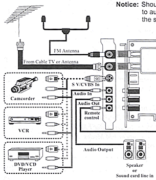

  5. Here is a diagram scanned from the manual which shows you that you can connect it to the VCR...

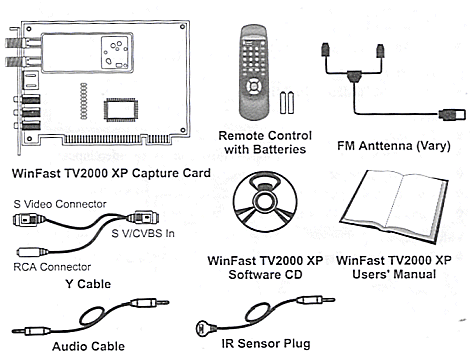

  6. And here it shows that it does come with an RCA connector...
    Just how do i connect it up?

    You plug that "S V/CVBS In" thingy into your card and you connect video cable from your VCR to "RCA connectror" of that thingy.

    Connect the "S V/CVBS in" end of the cable to your capture card. That cable is split to provide two different types of connections on the other end. One of them is a yellow composite RCA type connector. Connect your VCR to this yellow RCA connector and you should be set. Your VCR should have 3 RCA input jacks and 3 RCA output jacks on the back. They should be color coded - yellow=video red=right audio white=left audio. You connect the yellow "output" RCA jack on the back of your VCR to the yellow RCA jack of the "S V/CVBS in" cable. For the audio, you need to connect the red and white output RCA jacks on the back of the VCR to the audio input connectors of your capture card. Your diagram doesn't look like the capture card handles stereo - only one jack for audio. Later if you want to connect s-video for capture, use the other connection on the end of the "S V/CVBS in" cable.
