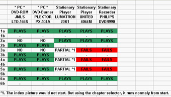

The conditions for my project are as follows….
Made a record (full movie) with the Philips recorder. Through all files to HD with DVD-Decrypter
and NO editing at all. Burned with mentioned software at various setting as explained.
1. Original movie recorded with Philips recorder to a DVD+RW (Sony).
2. Burned with NERO, with following setting’s.
DVD-VIDEO.
ISO-Level -1. ISO-9660 tacked. Non tacked restrictions. No tacked
Joliet. Mode 1.
a. Double click on the drive, or play directly on the stationery’s.
b. Find VIDEO_IFO and start the movie.
3. Burned with NERO, with following setting’s.
DVD-ISO.
No multisessions. ISO-Level -1. ISO-9660 tacked. Non tacked
restrictions. No tacked Joliet.
Mode 1.
4. Burned with NERO, with following setting’s.
DVD-UDF.
Force DVD-Video tacked. Physical partition. UDF-1,02
5. Burned with NERO, with following setting’s.
DVD-UDF/ISO.
Joliet. Mode 1.
6. Burned with RecordNow, with following setting’s
DATA.
Track at Ones (closed). UDF up to 128 file names lengths. No Joliet.
As you can see from the scheme, some of my recording is going right and some wrong. But now I know witch settings I should use to make a burning.
