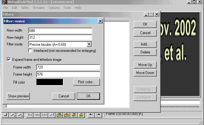

The easiest way I've found is to use FitCD (found in the tools section).
Point it at the AVI and it gives you a recommendation for the cropping and resizing as well as the required Bitrate for CCE. It can also create an AVISynth script for you if you prefer to use that instead of VDub.
I normally use "Bicubic Precise 0.6" as the resize method. -

Here the settings in VirtualDub. Well, the Vdub filter centers the image. With Avisynth you can add borders block aligned.

As Mr Grumpy suggested, I calculate the framesize with FitCD. 720x576 is the DVD PAL resolution, but no TV will display the entire picture. Search the forum for "overscan" to get detailed informations. So why should you encode video, that you can not see? Also it saves bitrate to the watchable picture. The overscan area varies from TV to TV. The overscan area of mine is rather large. However, both the Avisynth script and the Vdub settings add borders around the image to end with the DVD compliant 720x576 framesize.
