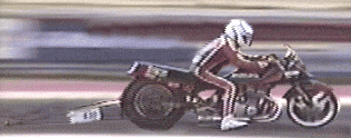

    I'm having a huge problem and my hair is going up now. I have captured DV. When I view them, I see those disturbing horizontal lines, which is only on pc-monitors, cause they use no fields. Now, after editing, when I render to any format, with fields off/upper/lower, deinterlacing on/off....those lines are always there...I really tried every possible setting.
    I don't understand it anymore. I always have this problem with DV. When I capture from analog devices, no problem at all....

    If your looking at the video on a pc you will notice the lines. But it should be fine on a TV. If you have powerDVD, try opening the files as it has deinterlacing filter on when viewing video.

    DV is always bottom field first (odd) also to keep in mind , if you want to deinterlace DV(dont know why you would unless your working with a 24p camera) , you have to split the fields
  4. Maybe I should have said that the final rendered movie must be viewed on a pc. I know when wathing it on a tv I won't have these lines, but on the pc they are still there.
    How do I split fields under Adobe Premiere 6.5 to avoid the lines?
