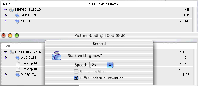

I have used this tutorial many times very successfully ... in both 5 and 6 ... so .. thanks a lot Galactica ...
But I am running into something wierd and new ...
those pesky DS_Store or Desktop DB / Desktop DF files only show up when I hit the record button ... and i cannot remove them ...
when i still have the chance to hit "cancel" those files go back into hiding ... so .. i cannot remove them anymore ...
this has not happened before .. but now it happens in 5 and 6 .. in 5 i can still cancel, in 6 it already starts burning and i know i will have a coaster ...
P
here a screen shot (at least i am trying
actually, what it looks like is NOT that the .ds_store are coming back but rather your are just seeing the addition of desktop files in v5 of toast. I am pretty sure these wont do anything - ie cause coasters.
Can you tell me you get the same response in Toast 6?
If so can you post those screenshots??? -
What came out of T5 sure was a coaster ...
in T6 it also happens that those 2 desktop files only show up once i started burning ... in 40 minutes i will know if i have another shiny frisbee.
What is puzzling is that I must have burned 50 DVDs in the last couple of weeks using t5 and t6 and that has not occured yet ... i was able to delete / remove / clear what i wanted and nothing else showed up once i hit record ...
cheers -
after talking on iChat I still think you should contact roxio about this.
I am aware that this should not happen for dvd.
I never see desktop files being added after i hit burn. only on cdr data will i see that, and that can be turned off. -

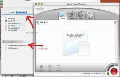

Hi!Originally Posted by caipirina
In Toast 6, in the Advanced tab as shown in your picture,
right below that, there should be a radio box
that is either checked or unchecked, that says
"Copy Desktop Database".
If you leave it unchecked, you should not see the file Desktop DB
show up in your burn.
To rid yourself of .DS store files, you can use Cocktail, .DS Store Cleaner,
or 20 or so other products from www.versiontracker.com.
I use Cocktail to remove the .DS store files ( version 2.21) and then
run the Pilot, BEFORE I do any burning on my main disc, as well as
the partitions from which my DVD2One Backups are stored, and when
I go to burn, there is no problems, and these files do not show up. -
terryj
can you post a screenshot
I dont see this ANYWHERE on my Toast 6!!! -

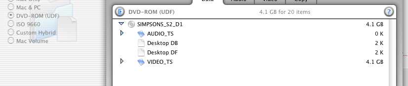

well yes..... for cd's
but what about dvd's!
the option dissapears as soon as you click DVD-ROM UDF -
hmm...
ok I see that the option does disappear on DVDs.
