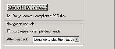

    I think I’ve just found what you have been looking for.
    When you go to the last of the menu item “share” click on little triangle next to it and choose create disc.
    On the next screen on the bottom left click square like check mark, and then you have an option “Do not convert compliant MPEG files”
    Make sure that files what you are importing have the same exact. specs. what is set under “File-Make Movie Manager”. If not make “New” or modify existing format.

    Re-encoding has to do with DVD authoring.
    To avoid re-encoding, you must make certain that the attributes of your source file MATCH the project settings.
    For example, if you have an MPEG video at 720 x 480 with 48,000khz LPCM audio and you choose those same parameters for your disc burn, you should *not* see any re-encoding.
    If you have an MPEG video with different size attributes, then you'll definitely see re-encoding occur.
    If your MPEG video has a different BITRATE, then you'll see re-encoding occur.
    The key to faster, higher quality burns is to make certain the attributes of the source video and the output project settings MATCH.
    If the bitrate of your source video is slightly lower than the bitrate of your project output settings, and that box is checked, there should not be any re-encoding either.
