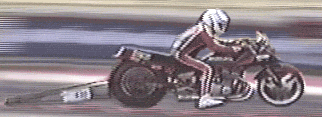

I just recently purchased a mini DV camera. It is only like VCD quality, and I was wondering if there is any way you can make the quality better in anyway using programs like premier, after effects, etc. Thanks.

Thanks. I don't expect the quality to look like DVD, but mine don't even look like VHS. When I buy VHS tapes at the store and play them in comparrison, they look way better to what my camera captures.
