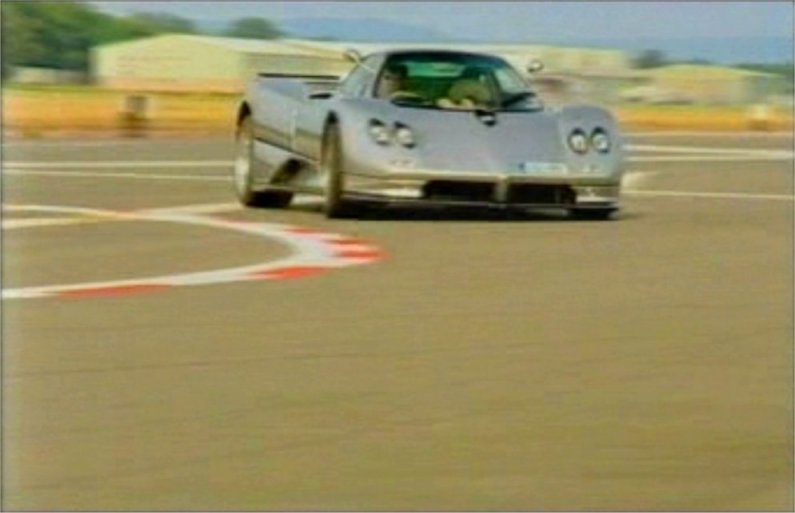

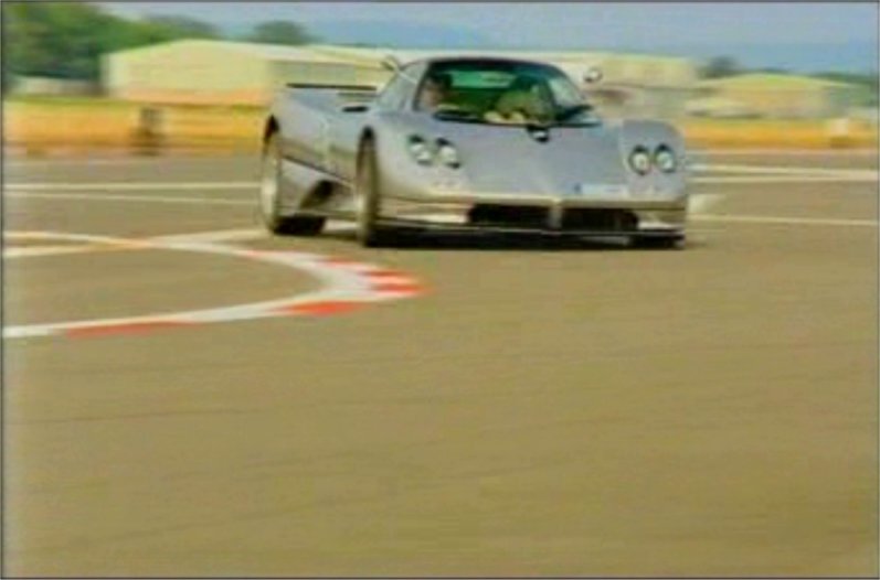

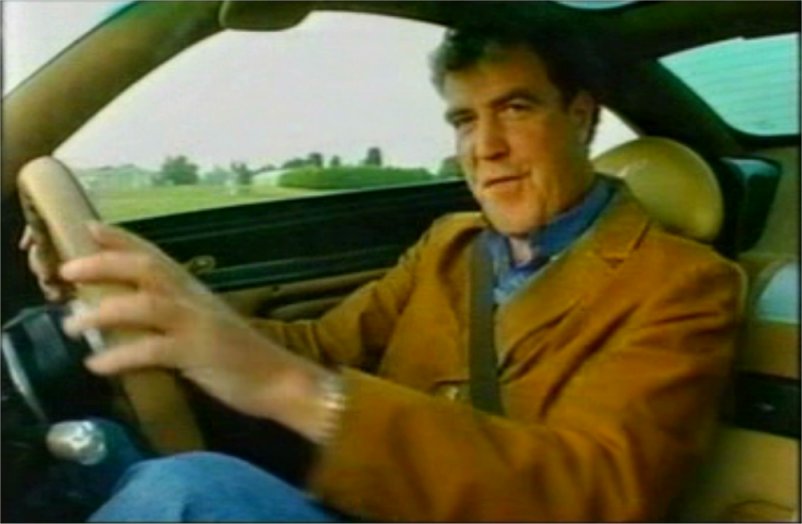

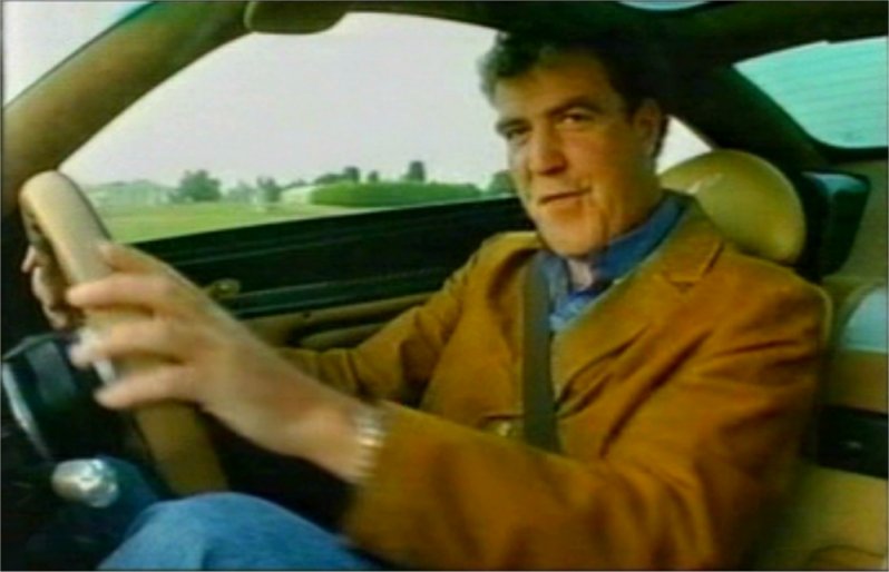

    OK, here's a screenshots I've taken from some VHS captures with the ADVC-100 that have been converted to VCD (CBR 1800) with no filters or codecs.
    They're from BBC Top Gear and have been resized to about 60% of the original to ba able to upload here.
  18. At 1800kbps that would be an xVCD. I doubt if you would have gotten as good a shot of Jeremy C at 1150kbps.

    OK, CBR1150

    The clip was played in full screen mode (1280x1024), and a screen capture (PrintScreen/SysRq) made and pasted into Paint Shop Pro 7. The black bars above and below were cut out and then the remaining picture was reduced in size to about 64% of the original to be able to upload it.
    I'd post the original mpeg clips if anyone wants, but the sequence is about 2 minutes long. If anyone wants, i'll cut them up and transfer by P2P. PM me.

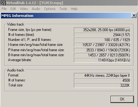

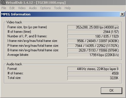

    Here's the data:
  23. Interesting to see the caps from the different bitrate samples. It's noticable that the 1150 one has far more artifacting - just look at the car body. It's what I said all along, for VHS caps you need a decent bitrate and VCD just won't cut it.

    I thought it was best to do the best capture, regardless of what you want to do with it.
    wrt the two clips, I'm hard pressed to tell the difference once they're playing on a 28" TV. I cartainly couldn't tell that there's 650Kbps (about 50%) difference between them. Maybe I need my eyes tested
    Regards,
    Rob

    I don't know about your eyes being tested, but I can see the artifacts in the lower bitrate one. Hard to know if it's acceptable of course unless you see the motion.
